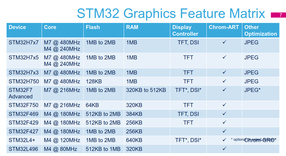

As far as I know there are specific models for using graphics, F4x9 etc. I use an STM32F407 with SPI display but in very simplified mode, low performance.

However, TouchGFX and similar programs rely on being able to write data to a specific pixel. If it's not a supported ST board, you're in the soup for making it so.
Now this does not mean that I understand the specific drivers in TouchGFX, but in general you need:
- A way of initializing the board, and likely clearing the screen
- A way of writing a specific pixel
- a way of reading a specific pixel
Different graphics programs may need more or less, but that is the minimum you need.
Generally, you need to provide a method for doing the above, which can involve having access to low level SPI drivers (HAL will work, but you may need one chip on one interface). These low level drivers depend on how your chip interfaces, how much graphics memory it has, how to access the registers on the control chip, and so on.
Many other programs (emWin, STemWin, uGFX, and so on, including what I have written) effectively do the same. There are more methods of writing to a display, but what I've mentioned are the simplest. Again, what kind of display, what kind of interface, and the display chip, all play a part.

By the way, seems like even STM32F413H-Disco board also will not compatible with TouchGFX.(correct me if I am wrong) I will definitely consider your points. But I need some more specific advise on application / library perspective. What would be effective for beginner stage. I thought TouchGFX. If it is not even suitable for STM32F413H-Disco board, will STemWin be good? or anything else?

Harvey missinform about not existed LTDC usw. But back to your q and ideas.
TouchGFX is compatible with F413, but only on SPI displays. I see no problem use it.
