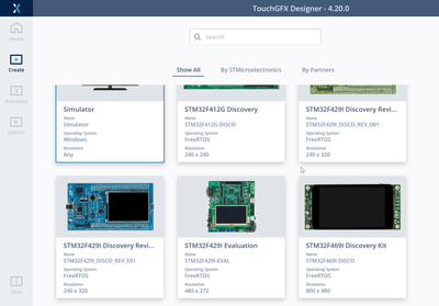

One option is to install TouchGfx Designer and look at the supported boards, then you can develop what you need on these and continue with your own design. There is a series of STM32 Discovery boards supported. For example the STM32F429I has 240 x 320. There are also references on the internet how to port TouchGfx to ILI9341 based boards typically supporting 240 x 320. If I was you and wanted to go the GFX path, I would first invest in a SM32F429I, make this work and then continue. The code generated by TouchGfx can be compiled with STM32Cube IDE and then downloaded to these boards without much problems.

Try start here Framebuffer Strategies | TouchGFX Documentation
