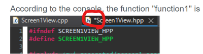

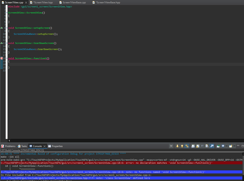

I got a problem when building the project in the CubeIDE.

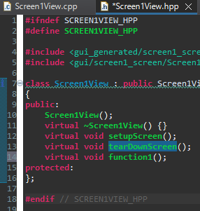

According to the console, the function "function1" is not declared, but in the .hpp it is.
I think the .cpp is not realizing that the .hpp is changing.

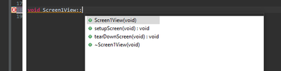

Here, when I use the content assit, function1 doesnt show up.

You need to save the Screen1View.hpp file before the IDE will recognize the new function. The "*" in the filename indicates it has been modified without being saved.
