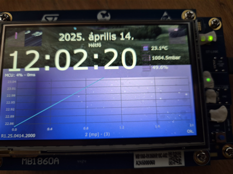

I have a funny issue. I just wanted to add a Share button to my Main Screen in an STM32TouchGFX of a working Weather Station app but when I built and run the app in STMCubeIDE all the widgets which uses background images showed surprising garbage images.

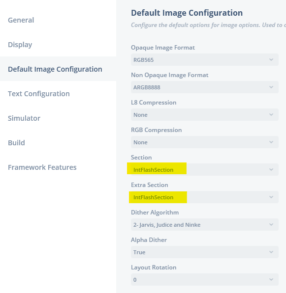

Then I changed the Section and Extra Section to IntFlashSection in Default Image Configuration group of Config menu of STM TouchGFX:

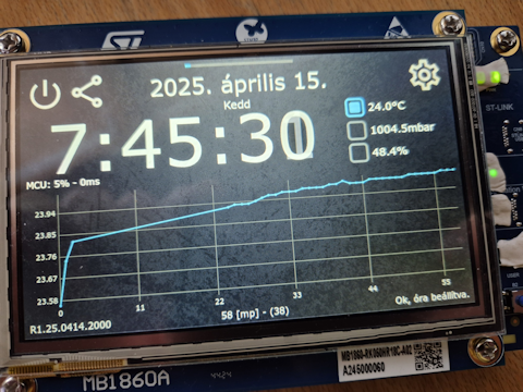

Then I rebuilt and run the app and everything worked just fine:
Who understands this?
I Checked the HSPI configuration in STM32CubeMX but I could not find any wrong settings for octo-SPI, so the external flash memory which stores the images (by default) seems to be okay.
In addition any ST Demo which based of TGFX works with external flash settings.
What could go wrong?

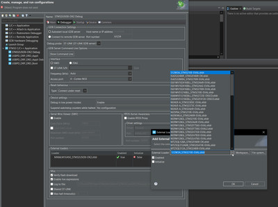

However, I saw that in STM32CubeIDE, you do not set the external loader on the debug.
To fix that, right click on your project in STM32CubeIDE, go to "Debug As" => "Debug Configurations" :
Then select your project followed by "debug", go to "Debugger", in the "External loader" section, click on "Add" and select your board:
Now you can try to flash on STM32CubeIDE.

I have never seen these warnings before. I have Hungarian translations but the translations appear on the screen right with accent characters so I do not understand it, especially the DELETE (0x7F) character.
Anyway, the result is a surprise. The right images appeared in all widgets even the external flash was selected in Config.
