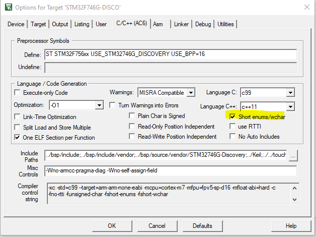

I figured out that:
TouchGFX only links when "Short enums/wchar" is disabled
Middleware only links when "Short enums/wchar" is enabled
Keil mentioned : "The wchar_t type must be the same in all source and libraries to successfully link."
Can you build the library with "Short enums/wchar" enabled? This should fix the problem.

2020-02-03 2:30 AM
Hi @Martin KJELDSEN
Thanks.
Now I get a lot less linker errors: (I enabled the "Short enums/wchar" option)

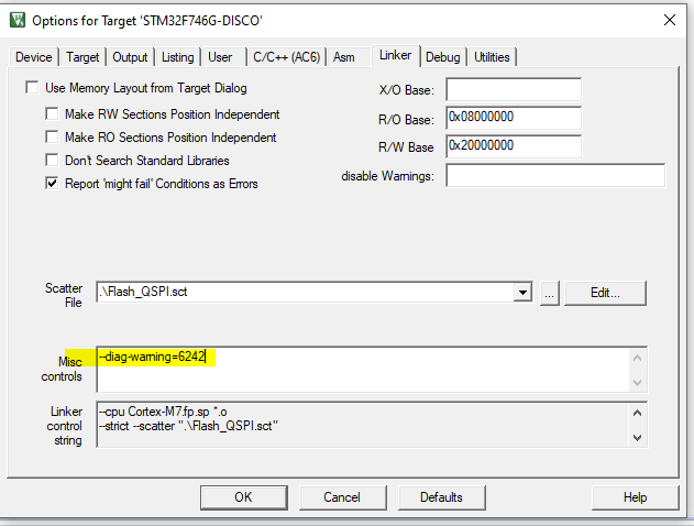

2020-02-03 2:50 PM
I tried it myself and got the same linker errors.
You can demote the linker error message to a warning by adding "--diag-warning=6242" in the Linker-Tab.
But I don't feel particularly comfortable doing this...

2020-02-04 2:45 AM
There are no special settings for those files and they inherit the global settings of "short wchar". I'll have to look into it.
2020-02-05 1:30 AM
I updated the library at the same link. I've managed to create a compiling (cmsis os code does not work well with ARMCLANG!) and linking project (Don't enable MicroLib).
