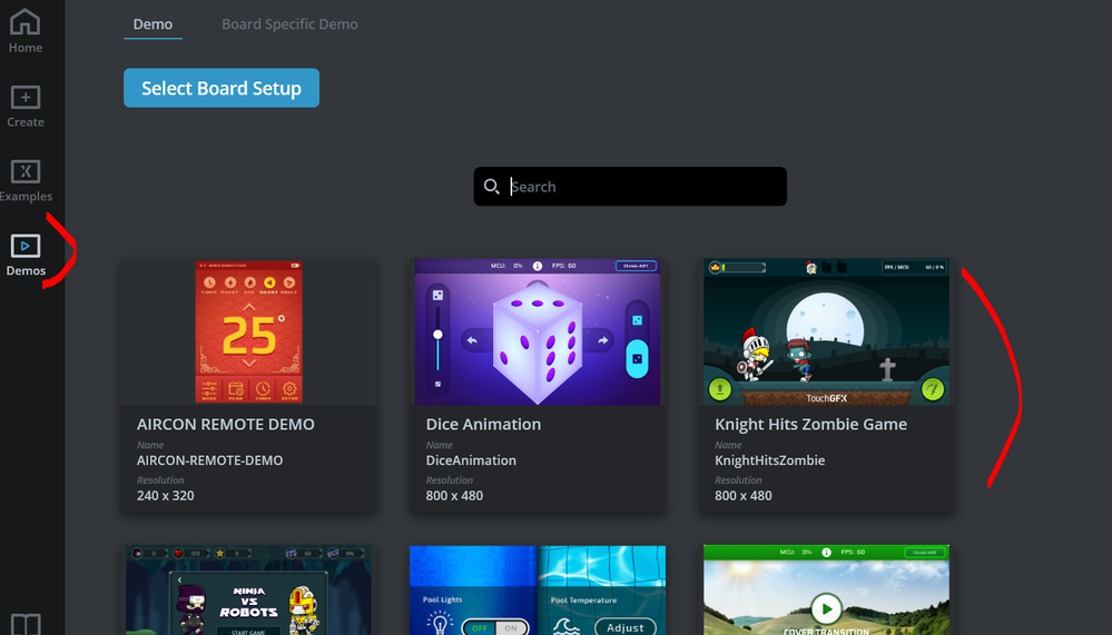

Where can I get the source code of Knight Hit Zombie game?
Used "TouchGfx Desinger"​ could generate the source code of Knight Hit Zombie game.
DNguy.14
Thanks you, I don't know it's an example already available in ToughGFX.
You can find it in the Demos tab in TouchGFX Designer.
