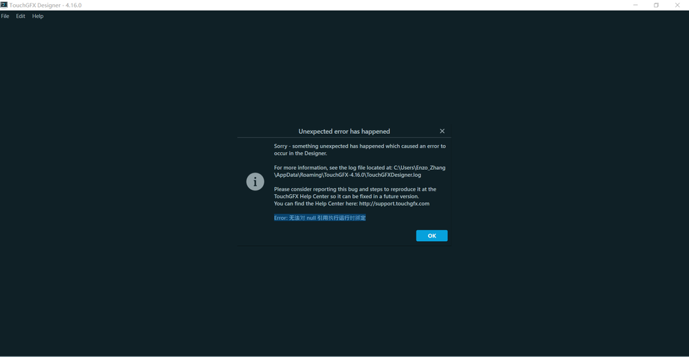

我在使用STM32CUBEMX生�?GUI代�?完�?�?�,在工程目录TouchGFX里�?�打开Applacation Template.touchgfx.part文件�?�,desigener报错,Error: 无法对 null 引用执行�?行时绑定,请问下这个问题怎么解决

OK,After using stm32cubemx to generate GUI code, I open the application template.touchgfx.part file in the project directory TouchGFX, and the designer reports an error. Error: I can't perform runtime binding on null reference. How can I solve this problem?Thanks~
Jzhan.81
Yes,I can reproduce it,it always does that,I haven't sloved it yet.
Jzhan.81
When I used STM32CUBEMX to generate GUI code,it's not appearing any warning and wrong.

Your touchgfx.part is empty. It should not happen.
Can you tell me exactly the steps you did to generate it ?
Did you use CubeMX, add the TouchGFX Generator additional software to your project and generate code ?
