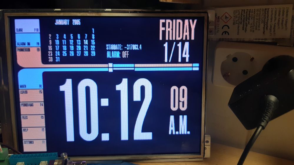

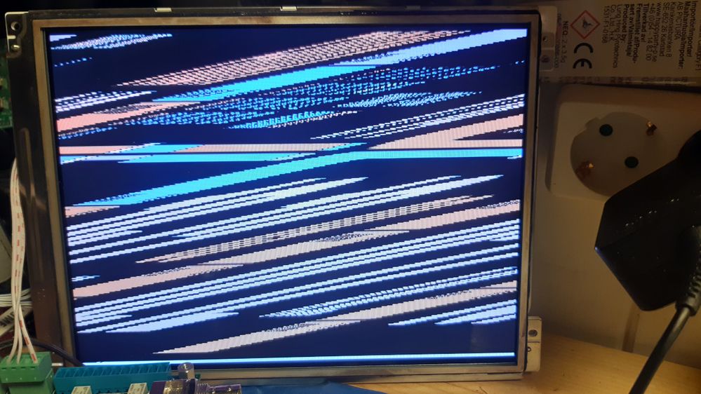

Here is the images showing corrupted and OK image
The only different is that the array size mentioned is 24 and not 25 for OK immage. Memory usage is 68%
EDIT:
Looking at the corrupted image you see that it is the same image as for the ok display. However, i noticed now that the 4 last lines are not part of the image. I guess this possibly indicates sync issue for when display expects first data and when the MCU transmits it.
You will see a similar behaviour if one deliberately program the frame start and stop addresses for layer 1 with wrong values (Either horizontal or line or both in register L1_WHPCR and L1_WVPCR), then you will also see this skew. But in the tests above these remains unchanged and should not be affected by the introduced code, and the clock/timing setup for LTDC is as mentioned earlier also unchanged.
I wonder if it could be sync issues with the enable signal but struggles to see how the code i insert (declaing the array) possible could affect this in any ways.
The display supports two settings for how to control the data enable signal, either by pulling it high when data is transmitted or by counting clocks while always keeping data enable low. I will recode and see if this might fix anything as soon as i get the time. Right now my rather old oscilloscope have trigger issues so I am not able to measure it properly.
