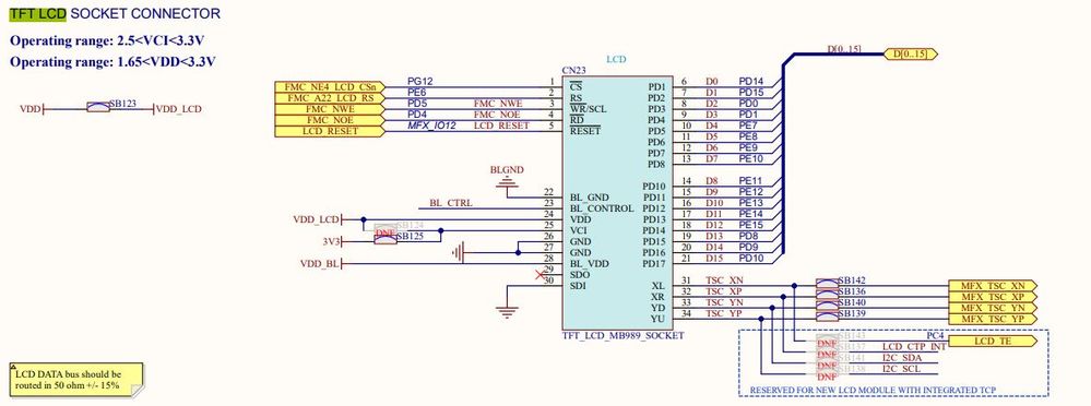

There's a dev board with a lcd, but the U5 doesn't seem to have support for the same LTDC that that chips like stm32L4 or stm32F7 does.
https://www.st.com/content/st_com/en/products/evaluation-tools/product-evaluation-tools/mcu-mpu-eval-tools/stm32-mcu-mpu-eval-tools/stm32-eval-boards/stm32u575i-ev.html#overview
Imen.D
Hello @Badam.17 (Community Member)​ ,

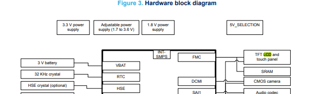

There is no LTDC in STM32U5, it's connected via FMC.
Please have a look at the schematic available here in the ST web site.
Check also the LCD connection in the UM2854 Evaluation Board with STM32U575AI MCU.
By the way STM32L4 has no LTDC too, only STM32L4+ has LTDC (STM32F4/F7/H7 with LTDC also).
