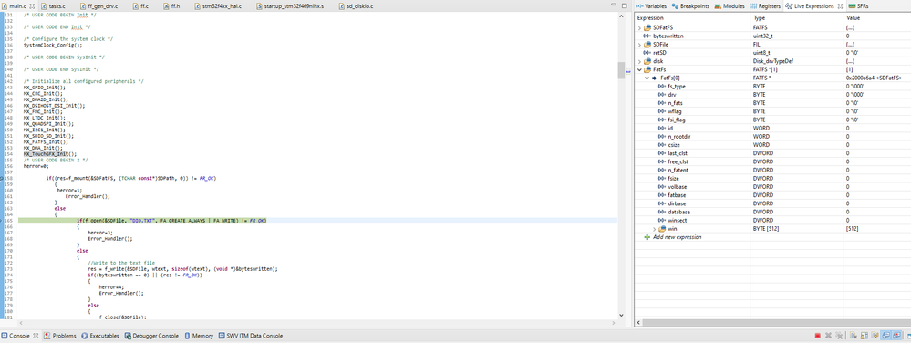

When I'm using TOUCHGFX and FATFS together, I can create/write/read a file in my SD only if I do it before "MX_TouchGFX_Init();"
f_mount(&SDFatFS, (TCHAR const*)SDPath, 0);
f_open(&SDFile, "DIO.TXT", FA_CREATE_ALWAYS | FA_WRITE); //with TGFX this one gets FR_DISK_ERR
f_write(&SDFile, wtext, sizeof(wtext), (void *)&byteswritten);
f_close(&SDFile);
f_mount(NULL, (TCHAR const*)SDPath, 0);

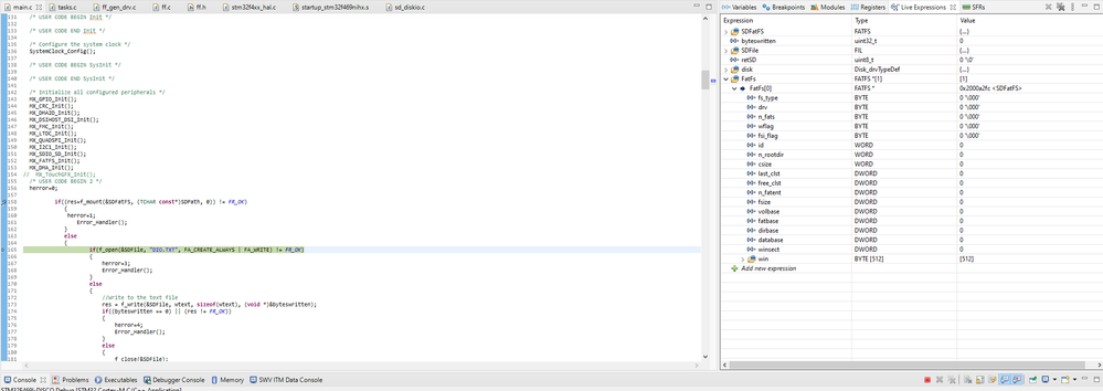

Not sure if this can be helpfull but the only difference I notice it's that when I debugging:
- If there is MX_TouchGFX_Init();, after f_mount(), FatFs gets the value : 0x2000a6a4 <SDFatFs>
- In other case, FatFs is equal to the value : 0x2000a2fc <SDFatFs>
Do you know if there is something I can do to make them working well after with the graphic application?
Thank you

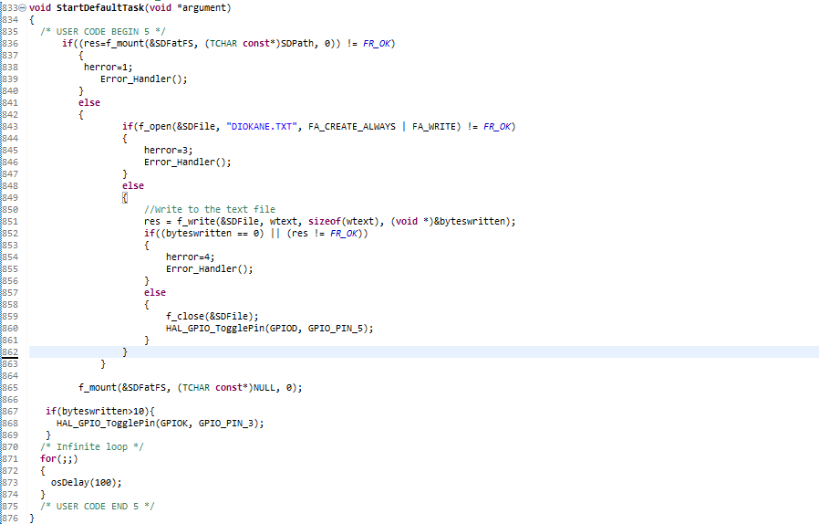

EDIT: I resolve it. I suppose because MX_TouchGFX_Init() is written in C++ inside that the FATFS methods could not be read in C so I put it inside a task and it works!!!
