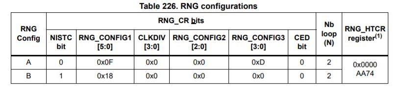

I have just updated a board design, replacing the STM32L433CC with an STM32L4P5RE. I have no problems using the RNG on the L433. However, with the L4P5, I get only one result from the RNG before it give a seed error.
RNG: CR = 00800004, DR = 9a4c8249, SR = 00000001
RNG: CR = 00800004, DR = 00000000, SR = 00000044

Hello Rob,
In RM0432 page 1088 you can find the right configuration for the RNG registers. When writing the HTCR register the magic number 0x17590ABC must be written immediately before the indicated value.
This is an example of the RNG config with Config A:
#define RNG_MAGIC_NUMBER 0x17590ABC /* Magic Number */
#define RNG_HTCR_VAL 0x0000AA74 /* HTCR Value */
__IO uint32_t HTCR_VALUE=0;
//put this after the RNG initializition and before the infinite loop
RNG->CR = 0x40F00D40; // config A
HAL_Delay(20);
/* RNG HTCR value setting 0xAA74 */
/*!< magic number must be written immediately before to RNG_HTCRG */
RNG->HTCR = RNG_MAGIC_NUMBER;
RNG->HTCR = RNG_HTCR_VAL;
HTCR_VALUE = 0 ;
HTCR_VALUE = RNG->HTCR;
while ( HTCR_VALUE != RNG_HTCR_VAL); // check that HTCR value is correctly set
RNG->CR = 0x00F00D4C; // config A + RNG EN =1, IE=1
HAL_Delay(1); /* a delay to wait for CONDRST to take effect */

2021-04-28 7:53 AM
I saw that in the reference manual. This indicates that there is a problem with the HAL. Can I expect that this will be addressed in a future release?
2021-04-29 2:46 AM
Yes, it will be corrected in the future.
