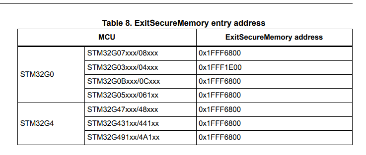

what is this Exit Secure Memory feature in STM32 system bootloader in AN2606 Application note? As per the application note it is used for secured exit from boot and entry from application. kindly explain clearly

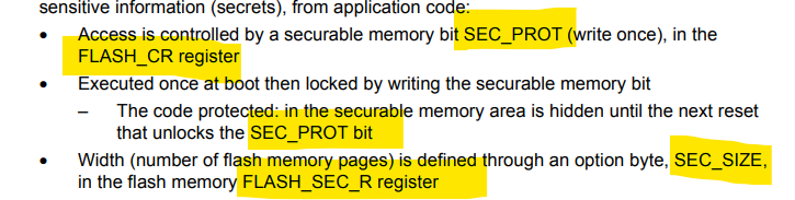

Whether this feature is applicable for only stm32g series listed below. Highlighted registers are not available in stm32f401

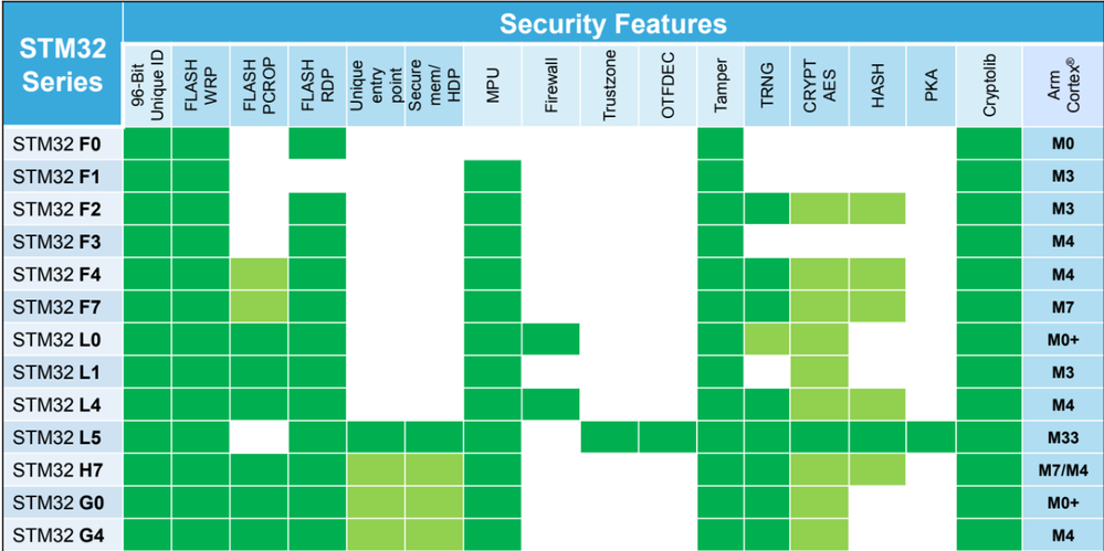

Simply because this security feature is not available in the STM32F4 series, there is no securable memory area. You can check this table that summarizes the security features of STM32 products :
or check AN5156 : Introduction to STM32 microcontrollers security
