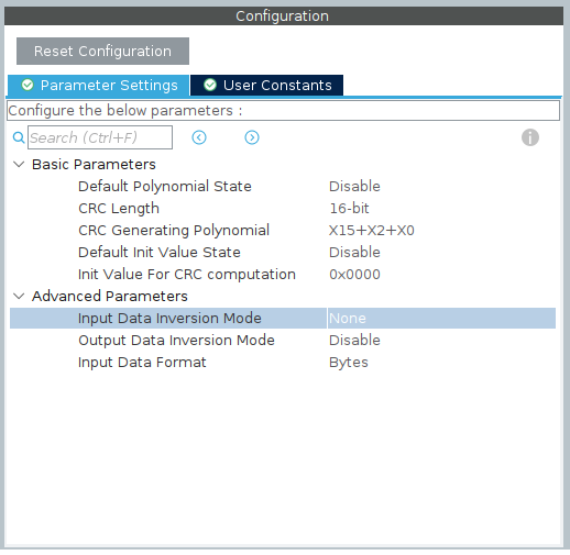

Hi community, I am working on CRC generation with polynomial 0x8005 and initial value 0x0000, so I configured it as below
_legacyfs_online_stmicro_images_0693W00000bkgUXQAY.pngI am using the data as shown below and the CRC should be 0x43B8 but the value got from the API is different. So I am missing something.
uint32_t bufer[] = { 0x23, 0x41, 0x54, 0x4F, 0x4E, 0xFF, 0x53, 0x4C, 0x30, 0x43, 0x55, 0x52, 0xFF, 0x0A, 0x30, 0x31, 0x32, 0x33, 0x34, 0x35, 0x36, 0x37, 0x38, 0x39 };
uint32_t crc = HAL_CRC_Calculate(&hcrc, bufer, sizeof(bufer));
I appreciate your input.

waclawek.jan
May 23, 2023
> uint32_t bufer[]
Are you sure you didn't mean uint8_t buffer[]?
Tesla DeLorean
Guru
May 23, 2023
Not the MODBUS one, but the reverse 0xA001 vs 0x8005
https://community.st.com/s/question/0D50X00009XkhPASAZ/stm32foxx-crc-usage-of-hal-drivers
But needs to BYTE feed for sure.
You sure on the 0x43B8, I get that in the reversed / inverse sense. The STM32 is a left-shifting beast.
Do you have other exemplars ?

newbie_stm32
May 24, 2023
Hi @Community member​, yes you are right it's a typo. The CRC is 0x43BD. But I got 0xe2cb after changing it to uint8_t.
waclawek.jan
May 24, 2023
Have you changed the array type?
Your link2 gives me 0x43BD too, btw.
newbie_stm32
May 24, 2023
Hi @Community member​, It's a typo it must be 0x43BD. I changed the array size to uint8_t and got a CRC of 0xe2cb which is CRC-16/BUYPASS.

waclawek.jan
May 24, 2023
As Clive (Tesla) said above, you have to swap the bits order. You did not tell us the STM32 model you are using, but you may be able to experiment with bit ordering in CRC_CR.
