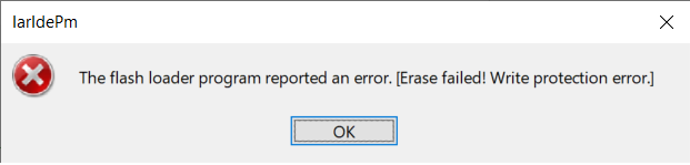

I have flashed the SBSFU application with write protection enabled for flash address 0x08000000.
After that, I am unable to erase using jlink commander.exe as well as by IAR->project->Download->erase.
STM32H743 has SWD interface and i am using jlink debugger for connection.
I am able to connect jlink debugger. But i could not erase it.
0693W00000aJZHnQAO.pngPlease suggest me how to erase the flash of STM32H743II.

I am unable to connect with cube programmer through jlink debugger. It is custom board doesn't have onboard ST debugger. Any other way to erase the flash through jlink debugger?

@mr.1​ J-Flash package (available from Segger) has a special utility, JLinkSTM32.exe
<quote> This program is designed to reset the option bytes of a STM32 device to their factory settings. If read protection of the device is enabled, reset the option bytes will cause a mass erase.</quote>
Try it. You can also ask in the Segger J-Link or J-Flash forum for more info on its use.
I tired with STM32 unlock command line tool. But it is failed to make in default factory setting
