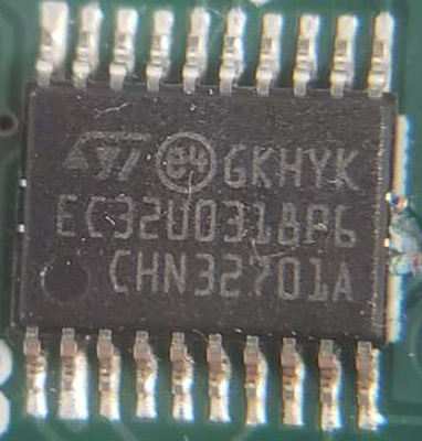

‎2024-09-25 8:46 AM
Hello @DJens ,
I guess your marking is ES32U031 something. ES means Engineering Sample.
I checked on a Nucleo STM32U031R8.
I don't think bootloader version read by programmer is the good one any way.
The address of bootloader version can be found in AN2606 Rev 64 p42: 0x1FFF37FE
And value should be 0xB0. This is the one I see on the Nucleo board.
So, I would suggest getting recent parts that are not engineering samples.
Best regards
Jocelyn
‎2024-09-25 9:34 AM
Thank you Jocelyn: I would obtain production parts but they are not in production yet. I will work with my sales folks to obtain real production parts (STM32U031F8P6)
I confirmed the bootloader version by reading the flash location in STM32CubeProgrammer. I confirmed that most of my parts have empty flash at this location but I did find one of the parts I have mounted shows a valid 0xB1 in the bootloader version location. Now I'm not using the bootloader for anything, but I don't know what an empty bootloader version implies as far as the RDP issue I'm having.
All but one of my parts shows this (and the STM32CubeProgrammer cannot modify the option bytes either)
I have one part that shows a valid bootloader version in flash. I will continue testing to confirm if this one will allow option byte changes. I need to be very careful not to lock up this part because its the only one that might work!
All parts are marked like this:
Let me close with this question: All I seek is to program parts and verify they have been programmed correctly (which requires reading back the flash contents) but results in RDP level one after programming. Programming will be done by a distributor programming parts offline. What is the standard practice for delivering a single binary image for programming that accomplishes this? I do not know what type of programmer the distributor will use, so I can't depend on them using STM tools with scripts. is there an app note that covers 'distributing binary images which are read protected'?

‎2024-09-27 2:46 PM
Panic over.
I received production silicon today. Swapping out the EC silicon resulted in expected RDP=level 1 operation, so the main issue is resolved.
Thanks for the help,
Doug
