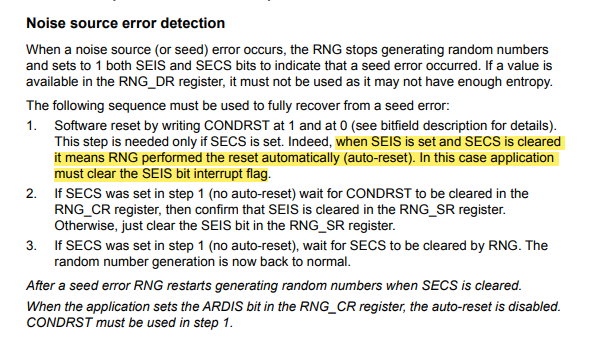

After investigation, I've seen that bit SEIS in RNG_SR is set. (while CEIS=0)
Despite reference manual stating in this case, it means some thing went wrong and RNG was able to auto-reset and recover, I think this is what is preventing PKA INITOK to be set.

‎2025-01-14 6:29 AM
Hello @hicham75 ,
Thank you for sharing this.
You will need to clear this flag as you don't have SECS and only SEIS is set indicating that the RNG has automatically recovered for the error and you application must clear this flag in order to make PKA init working properly
it is worth noting that this will not impact the security entropy or performance of your application since you are using the recommended configurations in AN4230.

‎2025-01-14 6:32 AM
Hi @STea ,
Thank you for your reply.
Unfortunately, I've already read that in another post. I tried to clear it but it will be set few instructions later.
Even, If I ignore it and proceed, PKA_SR_INITOK will not be set and PKA init will timeout.
I think it's related.
