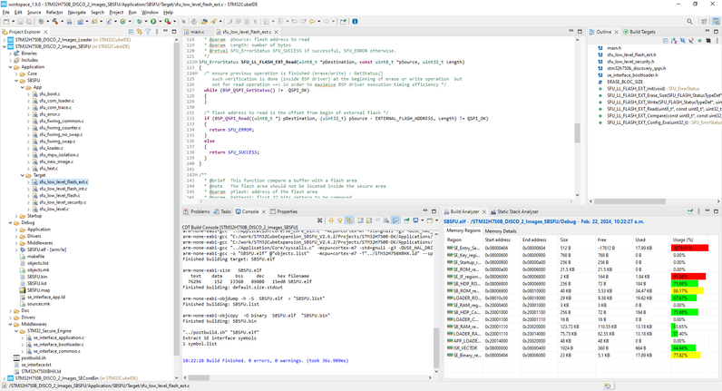

I try to build the STM32CubeExpansion_SBSFU_V2.6.2 for STM32H750B-DK. I use STM32CubeIDE Version: 1.9.0 on Windows 10.
The build result is suspicious:
More details:

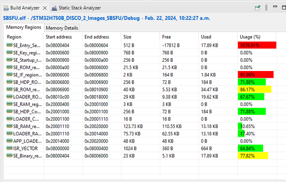

The first section is overflown by 3479%. What I did wrong? How to fix it?

Hello @tarbal ,
the build overflow is normal. It is related to the way Secure Engine binary is integrated inside SBSFU build.
