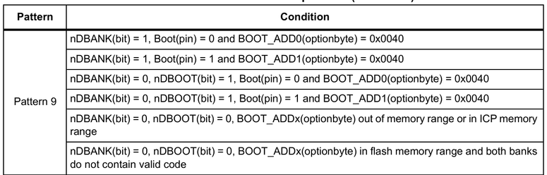

Hi MM,
I have gone through the following link:
https://community.st.com/t5/stm32-mcus/empty-check-mechanism-on-stm32/ta-p/49369
This says Empty check mechanism need to be done only for the following series:
F0, C0, G0, L0, L4, U0, WL & WB.
The series I am using is F7. I think Empty Check Mechanism is not applicable for STM32F765.
Empty check is only in system bootloaders. Your own bootloader is normal application here... RESET jump to it one line of code. Call NVIC Reset or start watchdog = reset.
Hi MM and all,
Thank you for responding to my queries. I could solve the issue by jumping to the custom bootloader start address 0x08000000 after disabling I Cache and D Cache.
