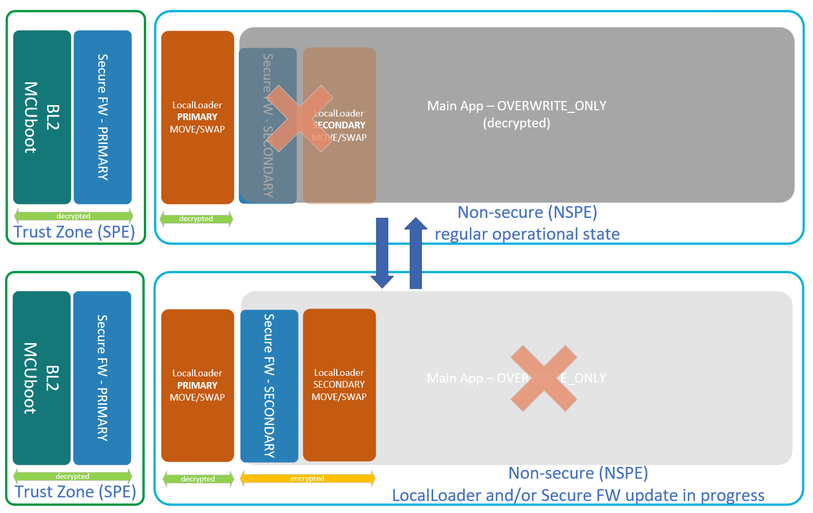

What I need to implement is a very typical real-live scenario - a device (let's imagine it is a fancy coffee machine) based on STM32U5G9 MCU which will be periodically updated by a qualified service technician from USB stick (Y-modem etc. is not considered a modern/convenient hence acceptable solution). Therefore, only the boot loader and the USB Local Loader apps require 100% secure updates (two slots) since any update failure would brick the device. As long as Local Loader is healthy, failure to update the Main App is not a problem, another attempt, e.g. using another USB stick can be easily made.
On the contrary, the Main App, which will be loaded from USB stick by Local Loader and updated the most frequently, does not require primary/secondary slot since the ability to utilize the maximize remaining flash area is way more important.
Needless to say, the Main App image has to be encrypted and signed thus Local Loader needs to be able to verify the signature of the firmware image temporarily placed in SRAM and decrypt it. I do not mind if Secure FW or Local Loader update wipes out the Main App - probably it will have to be updated anyway. Likely Main App image will have to be compressed before it is encrypted and delivered and then decrypted because otherwise it may not fit into available SRAM, unless decryption is done on-the-fly but this is less of the problem.
Conceptually, what I described above is Trusted Client scenario, defined in PSA-API, section 3.3.3.

Hi @Jocelyn RICARD, Unless I am missing something, SBSFU consists of two applications: secure and non-secure. At least this is what docs state all over the place. Only two images: bootloader combined with secure services running in trust-zone and the main non-secure user application.
By default, TrustedFirmware-M (TF-M) uses 3 images: MCUboot (BL2) which is NOT updatable (at least not easily), updatable secure services image (runs in TZ) and the main non-secure application image. Needless to say, ability to update secure services is a very nice feature. Ofc, I may never need it but if I do and it is not an option the product has a problem. It is all about risk mitigation (e.g. currently unknown vulnerabilities) and flexibility to add new features hard to foresee initially. The product hopefully will live for many years and will continue receiving software updates.
Since my first user application (local loader) needs to be able to at least verify signature of the image it downloads in order to early report new firmware problem to the user, I need TF-M secure services very much. Otherwise, I would have to use (and store) another set of keys etc. in non-trust zone. This simply is not an option.

Hi @TDJ ,
I feel some misunderstanding. Let me explain.
SBSFU project provides:
1) One Secure boot project called SBSFU. It is the first application running after reset and is immutable. Cannot be updated in any way. This is the root of trust.
2) A secure application that is launched by SBSFU
3) A non secure application that is launched by secure application
The important part for secure boot is ONLY the SBSFU.
The secure application is already YOUR application. Secure application is responsible for configuring the security of the platform. So, it mainly setups the split of peripherals between secure and non secure.
Secure application can also offer secure services available from non secure application through a secure API. You have an example in the code.
Then once secure application had finished the initializations, it jumps to the non secure application.
Non secure application is the main application running.
SBSFU can update secure and non secure application. Depending on configuration, you can have one binary containing both secure and non secure for the update or you have one binary for secure and another one for non secure. In this last case, you can have a different key to authenticate secure and non secure. This could be useful if secure and non secure are not owned by same entity.
On top of this basic secureboot configuration, if you add TFM, then TFM completely replaces the secure application you had before. Non secure application will then be able to call secure API through PSA API defined by TFM.
In term of update by default, the mcuboot is setup so that you will update TFM and non secure application separately.
So, both solutions are very similar except with TFM you get secure services already implemented.
If you need TFM use it, if not use SBSFU solution.
Last point, the only entity able to verify the signature is the secure boot (mcuboot) because is owns the public key used for that. The loader that transfers the new update image in the flash has not this ability (or you duplicate the key but what for ?)
I hope this clarifies things
Best regards
Jocelyn

Hi @Jocelyn RICARD,
Thank you for this clarification. It did not immediately occurred to me that UM2262 publication describing SFSFU solution is probably very outdated. STM32U5, Cortex-M33 with TrustZone and MCUboot are not even mentioned.
Secure TF-M app I need exactly to be (e.g.) able to verify downloaded image signature from unsecure app without access to secure keys which, of course, cannot be exposed to unsecure app. Ability to handle scenarios like the one I described, best to my knowledge, is the very reason why countless hours have been spent to build TF-M solution, although it takes extra flash space and it is not just several kB. This is the area where SBSFU clearly falls short.
SBSFU solution deserves credit for being much easier to grasp, but TrustedFirmware-M (TF-M) has the functionality I need. Actually, way more than I need which, as you rightly pointed out, does not come free. ST's TFM solution was probably intended to bridge this gap. Too bad it appears to be abandoned.
