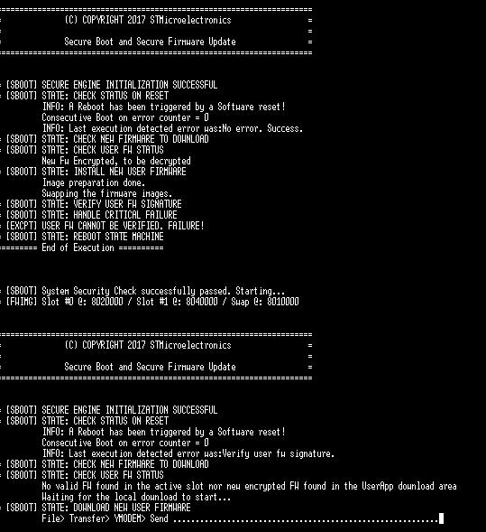

‎2020-11-13 12:36 AM
Hi Jocelyn,
Thnx for reply, I think, it needs more changes than above steps, anyway SBSFU is running on the custom board with dual image configuration(SBSFU V2.30),
but loading user firmware through sbsfu, it through error "FW CANN'T VERIFIED!" any idea!!!
I'll highly appreciate you for any help.

‎2020-11-16 1:35 PM
Hello Jitu,
Well difficult to guess from that point what happenned.
First did you manage to load the SBSFU_UserApp.bin to the target and have it run properly ?
Best regards
Jocelyn
