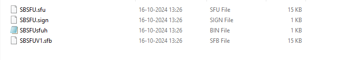

‎2024-10-16 2:43 AM
Hello
I have built the project and got the following files in my binary folder how I can upload the SFB file, I am using a custom PCB where I normally upload the code using an ST link. Using a cube programmer is it possible?
‎2024-10-16 8:40 AM
Hello @jijomathew ,
First it is not normal to see the .sign, .sfu and .sfuh files. They are temporary files that should be deleted at end of signing script.
In development only, if you removed all protections, it should be possible to download the .sfb file as binary in the download slot. After reset, the SBSFU should install the new application.
Now, I have never tried this on my side :)
The normal way to do, when you want to check the update is to download the .sfb file using a loader.
Best regards
