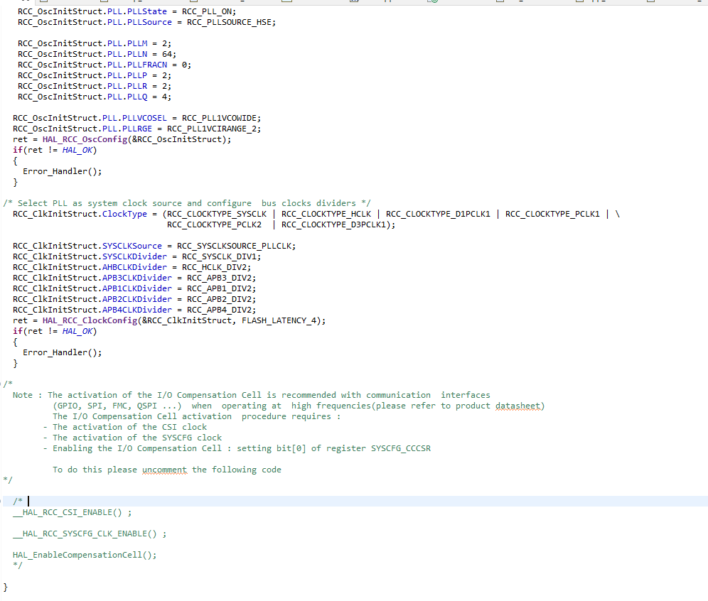

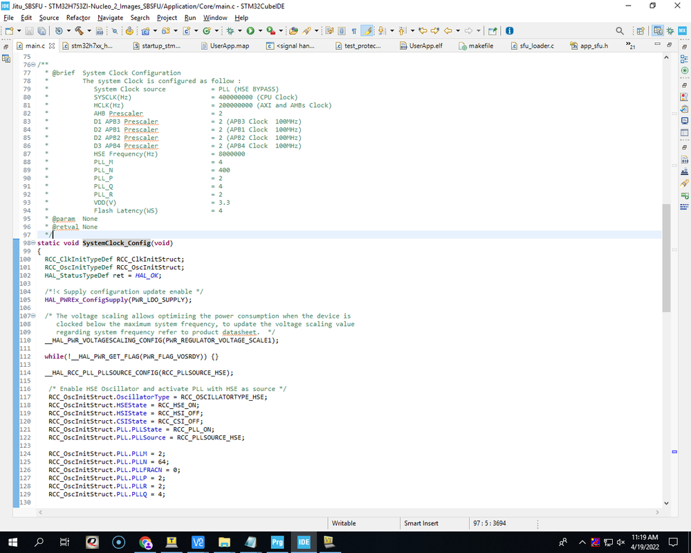

  1. My Nucleo STM32H743ZI board has a 25 Mhz External crystal, so I change the clock config in the SBSFU file STM32H753ZI-Nucleo_2_Images_SBSFU and STM32H753ZI-Nucleo_2_Images_UserApp as shown below images. Is it correct ? or not then please suggest the correct Clock Config as per 25 Mhz Crystal. 0693W00000LyHHDQA3.png0693W00000LyHG0QAN.png

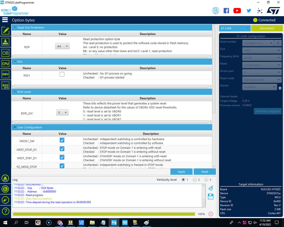

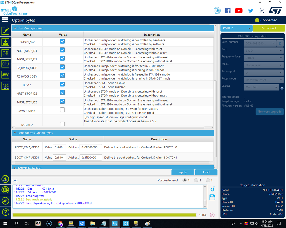

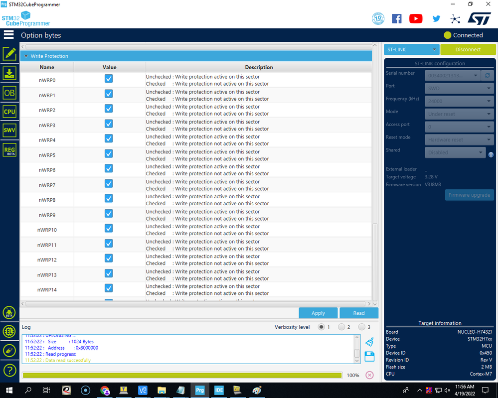

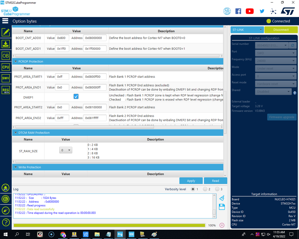

  2. What is the Option bytes configuration for Nucleo STM32H743ZI? I selected Option bytes as shown below image. Is it correct? If not then please suggest the correct Option bytes configuration for Nucleo STM32H743ZI MCU.0693W00000LyHebQAF.png0693W00000LyHevQAF.png0693W00000LyHa6QAF.png0693W00000LyHfAQAV.png

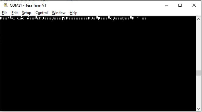

=> After Debug STM32H753ZI-Nucleo_2_Images_UserApp in the STM32H743ZI board, for the very first time Green LED blinks and code run in FW_APP_Run(); infinity loop but it does not show Log properly in Tera term I will attach Images for reference. Once I will Push Reset button or unplug and plug ST-Link (USB) then it goes in location 0xfffffffe as shown below.
Thread #1 [main] 1 [core: 0] (Suspended : Signal : SIGTRAP:Trace/breakpoint trap)
0xfffffffe
<signal handler called>() at 0xfffffff9
0693W00000LyI8vQAF.png@Jocelyn RICARD​
1. For the clock configuration, I recommend using CubeMX.
You can create a basic CubeMX project just to generate the clock as per your clock tree configuration.
Then you generate the oce and copy/paste only the clock configuration function form the generated CubeMX project to X-CUBE-SBSFU projects.

2. For the option bytes, you can refer to section 8.1 in this UM:
Getting started with the X-CUBE-SBSFU STM32Cube Expansion Package - User manual
It is not perfect but it gives a reference.
Then, if something goes wrong it should be captured by the SBSFU project when checking the option bytes at startup.
