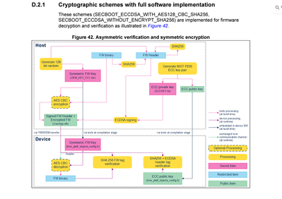

Hi Team,
I hope this email finds you well. I am reaching out to inquire about documentation similar to UM2262 but specific to the STM32H5 microcontroller.
We are currently working on a project that involves firmware encryption, decryption, and update processes for the STM32H5 series. To ensure the smooth execution of our project, we are seeking comprehensive documentation that outlines the procedures and best practices for implementing these processes effectively.
Could you kindly provide us with any relevant documentation or resources that detail the firmware encryption, decryption, and update processes specifically tailored to the STM32H5 microcontroller?
Your assistance in this matter would be greatly appreciated, as it will significantly contribute to the success of our project.
