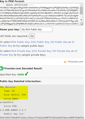

I have attached the result of the " Public Key Certificate " that I received from the SMAK application code.
As a result, we are getting an  Elliptic Curve Cryptography (ECC type certificate.
But as per UDAI Specification Ver 2.0 - 2022 ,  We need RSA 2048 Type certificate. Kindly support

Hello @RKOAS,
could you please give a bit more detail.
Are you talking about DUA certificates ?
Thank you
Best regards
Jocelyn
yes. Talking about DUA certifiacte.
Hello @RKOS,
Ok in this case I'm afraid there is no solution.
The 2 DUA certificates are based on ECC keys and this cannot be changed as these are provisioned in ST's secure factory before releasing the STM32H573 chip.
This is very probably a marketing decision based on the fact that ECC is more adapted to IOT world.
Best regards
Jocelyn
