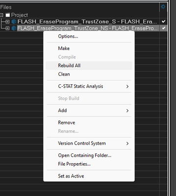

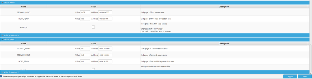

are you sure you are setting the correct option byte configuration mentinned in the Readme of the project ?
then the view of SECWM programming should be visible
then using IAR set the project secure as active and rebuild it
then rebuild the NS project (this is not done from your side that is why you get this error)
you should be good to go afterwords.

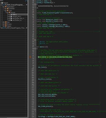

I am able to port the project using stm32cubeIde and able to compile and run on NUCLEO-U575 dev kit. But the example code isn't working as it is not able to read data against the data written into it.
project:STM32Cube_FW_U5_V1.4.0\Projects\NUCLEO-U575ZI-Q\Examples\FLASH\FLASH_EraseProgram_TrustZone\FLASH_EraseProgram_TrustZone_Secure
Data written 0x0102030405060708, 0x1112131415161718
Date Read 0xd1062800fdb9f7ff, 0xf451680106c4f8df.
Any help is highly appreciated.

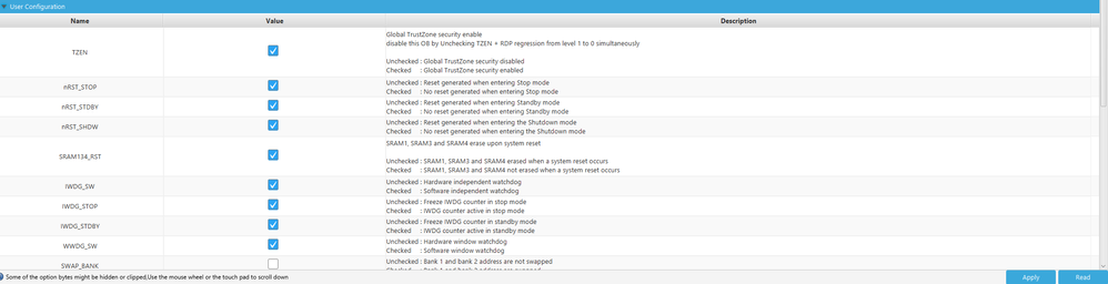

‎2024-10-11 4:23 AM
Hello STea,
First of all Thank you for your response, it worked for me after enabling TZEN bit. I am able to Read and write from Secure flash.

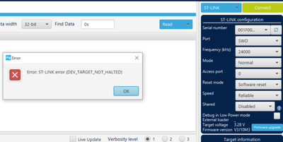

But I had an another issue when I wanted to disable Trustzone bit So first I changed the RDP from AA to DC in STM32Programmer software and clicked on Apply then I powercycled the board and pressed connect It showed DEV_TARGET_NOT_HALTED. The settings were mode set to Normal and Reset mode set to Software reset.
Can you please help to progam my board again.

‎2024-10-14 2:31 AM
Hello STea,
I am now able to program my device, I resolved it by programming the device using UART mode on STM32programmer by setting BOOT0 pin. I had another question Is there a way to Enable TZEN in the code without using STM32programmer.
