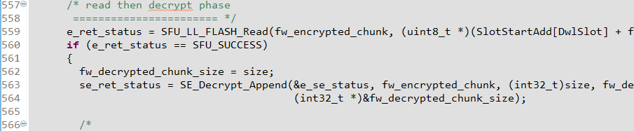

Thanks for the pointer @Jocelyn RICARD​
I see APP crash because the APP image is not decrypted but present in encrypted form at __ICFEDIT_SLOT_Active_1_start__
configure the active slot 1 in internal flash and download area in external slot.
#define SFU_NO_SWAP
__ICFEDIT_SLOT_Active_1_header__ = 0x08010000;
__ICFEDIT_SLOT_Active_1_start__  = 0x08020000;
__ICFEDIT_SLOT_Active_1_end__    = 0x081DFFFF;
/* Dwl slot #1  */
__ICFEDIT_SLOT_Dwl_1_start__     = 0x90400000;
__ICFEDIT_SLOT_Dwl_1_end__       = 0x905BFFFF;
Encryption set to
#define SECBOOT_CRYPTO_SCHEME SECBOOT_ECCDSA_WITH_AES128_CTR_SHA256 /*!< Selected Crypto Scheme */
I see the firmware from __ICFEDIT_SLOT_Dwl_1_start__ is not decrypted its just copied over to __ICFEDIT_SLOT_Active_1_start__
0693W00000HpjEwQAJ.pngAfter call SE_Decrypt_Append both fw_encrypted_chunk and fw_decrypted_chunk_size are same value.
#elif ( (SECBOOT_CRYPTO_SCHEME == SECBOOT_ECCDSA_WITHOUT_ENCRYPT_SHA256) || ((SECBOOT_CRYPTO_SCHEME == SECBOOT_ECCDSA_WITH_AES128_CTR_SHA256)) )
  /* Nothing to do as we won't decrypt anything */
  /* Prevent unused argument(s) compilation warning */
  UNUSED(SE_FwType);
  e_ret_status = SE_SUCCESS;
#else
#error "The current example does not support the selected crypto scheme."
#endif /* SECBOOT_CRYPTO_SCHEME */
  /* Return status*/
  return e_ret_status;
Which leads to application crash when we transfer control from BL to APP

I guess got it working with SECBOOT_ECCDSA_WITH_AES128_CBC_SHA256 @Jocelyn RICARD​ please correct if my understanding and fix are correct
1) We should not use #define SECBOOT_CRYPTO_SCHEME SECBOOT_ECCDSA_WITH_AES128_CTR_SHA256 since its not implemented in se_crypto_bootloader.c for STM32H7B3I-DK as OTFDEC is used by default.
2) With SECBOOT_ECCDSA_WITH_AES128_CBC_SHA256 the APP header address and slot address should point to same internal flash location same as per example of STM32H7B3I-DK 2_Images ?
#define SECBOOT_CRYPTO_SCHEME SECBOOT_ECCDSA_WITH_AES128_CBC_SHA256 /*!< Selected Crypto Scheme */
/*For  SECBOOT_ECCDSA_WITH_AES128_CBC_SHA256 header and start should point to same location */
/*__ICFEDIT_SLOT_Active_1_header__ = 0x08010000;*/
__ICFEDIT_SLOT_Active_1_header__ = __ICFEDIT_SLOT_Active_1_start__;
