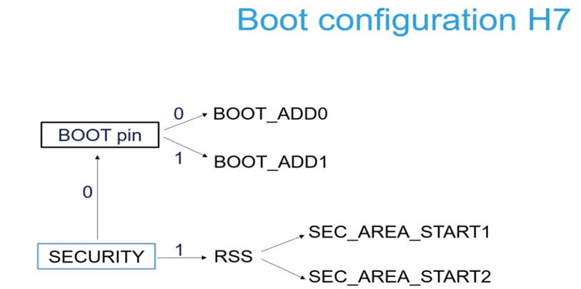

How can we configure SECURITY Mode for STM32H753
Do we have provision to configure STM32H753 as Secure Mode or not using SECURITY Pin in Boot selection ??
or is this completely owned by STM ??
is Devices received with enabling SECURE MODE it self ?? as mentioned in below Diagram ??
is STM does this SECURITY Bit Enabled in manufacturing itself ??

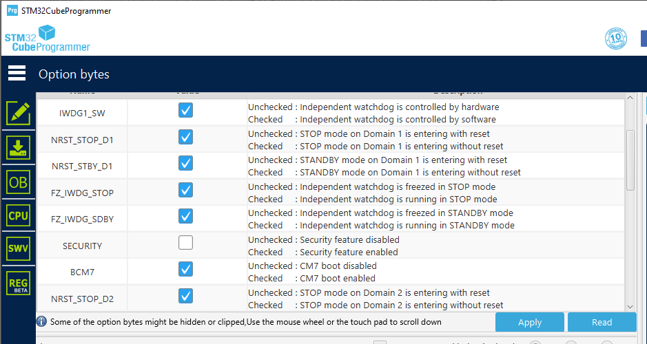

Should be this bit with Cube programmer:

Thank You @Fred​ . this i was aware, But through SBSFU application itself, i thought we can do.
So to achieve RDP LVL 2, we have to give Manufacturing instructions to enable Option Bytes for Production Mode. This is only Best option i believe.
