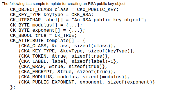

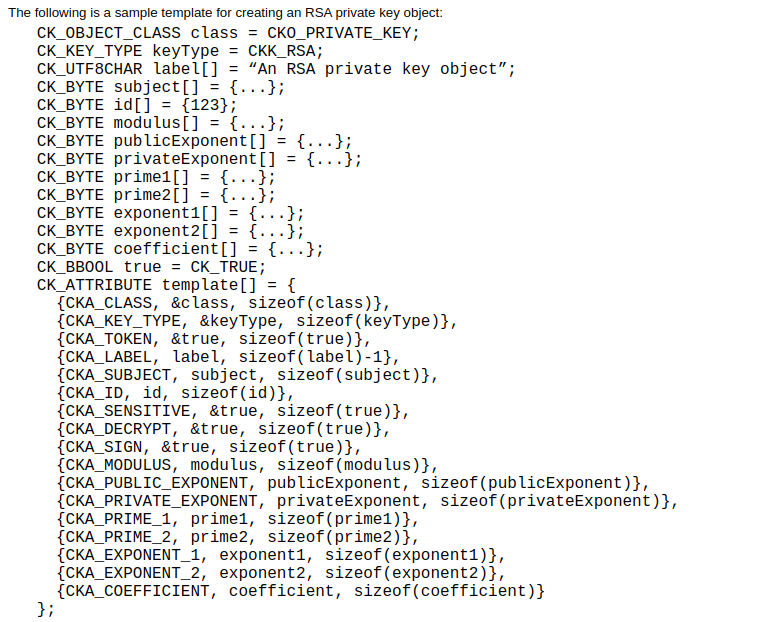

@Fred​ Thank you for the precision. So If i am not able to use it, I think I will go for another algorithm (RSA) as I can see from the provided example project that it is possible to sign and verify using RSA.
If I use openssl to generate a RSA key pair, do you know how I can translate the .pem files to these objects :
(public)
(private)
0693W00000NqTDeQAN.pngThanks,
Benjamin

There is an example of encoding in "kms_blob_example_keys.c".
But I can check with the colleague who developed it how he created the data.
BEnge.1
BEnge.1Author
May 23, 2022
Yes I saw the example but I was wondering how the data was generated. I think the required information can be found using
openssl rsa -in <my_key.key> -noout -text
but if you can check with your colleague that would be very much appreciated.
Fred
May 25, 2022
Unfortunately, nobody had to store lots of keys, so the colleagues who worked on it made the mapping manually.
