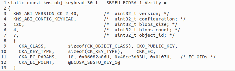

The issue was that because I use the KMS, the ECC public key is inserted in the kms_platf_objects_config.h file during prebuild.sh but for some reason even though i changed the private key in 2_Images\2_Images_SECoreBin\Binary. The public key was not updated during build.
So what I did is :
- update the kms_platf_objects_config.h file like that :
- Clean the Secure Engine, SBSFU and my Application project
- Rebuild the 3 projects and as the @ECDSA_SBSFU_KEY_1@ was present in the file, it was replaced by the correct public key when running the prebuild.sh during the build of the Secure Engine project

Thank you for the help everyone.
So what I did is :
