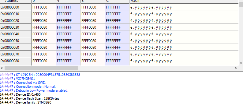

Currently developing a product to update the firmware of a product through SWD, i encounter an issue with the flash of the target (STM32G070RB).
After multiple changes in the RPD (from 0->1 & 1->0) the flash of the MCU can't be erased.
Some word will not erase to 0xFFFFFFFF, but instead will be at 0xFFFF0080.
Once it's in that state, changing the RDP to trigger a mass erase will not fix the flash. The STLink is unable to mass erase or page erase the chip, and also unable to program anything to the chip.
Initially i though that my programmer was the issue of the flash error of the target. But when it happens it was when changing the RDP from 1 to 0 with the STLink. I was not sure of that on the first occurrence of the issue. But today it happened again, while not using my own programmer at all.
So i am now sure that it happen after changing the RDP from 1 to 0 using the STLinkV3.
Does anyone already encounter this issue?

Hello @Imen DAHMEN​ , thanks you for your reply.
The STLink V3 i'm using is currently in the V3.J7.M2.B4.S1 version. The issue happened with two MCU, both are STM32G070RBT6 on a custom boards (not the same board in the two occurrences of the issue).
I'm not using the STM32CubeProgrammer, but the STLink utility instead.
When the bug occured the RDP change worked as expected changing from 1 to 0. But the mass erased triggered by the RDP change failed to erase the flash properly. Instead of that the whole flash is a set to 0xFFFF0080FFFFFFFF.
When the MCU is in this state i can still change the RDP using the STLinkUtility. From RDP0 to RDP1 and RDP1 to RDP0, without issue, except for the flash.
When trying any type of erase using the STLinkUtility i encounter an error. Same when trying to program the MCU.

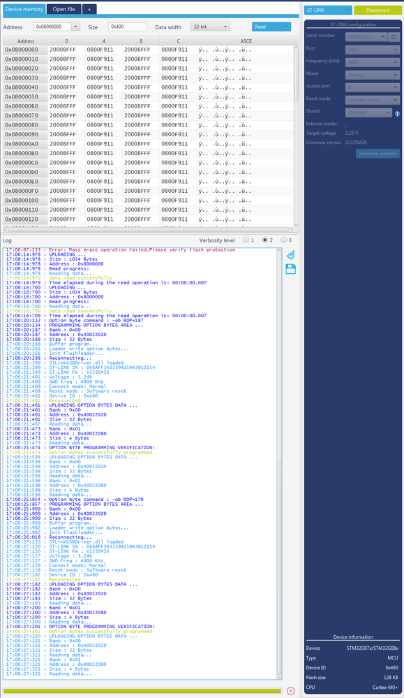

Ok so after soldering the last faulty STM32G070RBT6 to a NucleoG070, and using STM32CubeProgrammer i obtained interesting result:
-The flash read initially returned the same values i had with the STLinkUtility (0xFFFF0080FFFFFFFF)
-Chip Mass Erase returned an error
-RDP changes are working, BUT after few changes the flash changed value, as you can see in the next screenshot:
Nothing else changed. The flash is still stuck in this state. Can not program/erase the chip.
