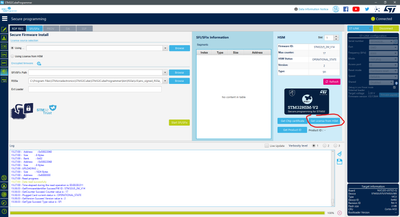

I followed the secure image tutorials as can be seen in AN4992/AN5054  or in videos made available by ST. The process takes place without errors, as can be seen in the images below (start address is 0x08000000).
Smart card is valid and working:
However, when trying to burn the image, either via stm32cubeprogrammer or via command line I get the following error:
Error: Execution of RSS CMD failed, returned value = 0x1
Has anyone experienced this problem? Any recommendations ?

Jocelyn RICARD
Hello @Marcelo Barros ,
in the option bytes csv you have set the RDP to 0xAA which means RDP Level 0.
Also, you are set TZEN to 0
This is not possible to have such setup.
SFI is a secure firmware installation, so it requires at least TrustZone to be enabled and also RDP Level 0.5 which provides the flash protection for secure flash sectors.
Besides I advise you make your tests using the license in the file instead of reading it from the smartcard.
For this, you need to ask for the license related to the chip you are using for testing: This will consume one license in the smart card; but you have the license file binary in a file that you can reusing as many times as you want as long as you use the same chip.
Best regards
Jocelyn

Jocelyn RICARD
Hello Marcelo,
Here is how you get the license from the chip.
You connect with STM32CubeProgrammer and select the shield on the left icons. Then SFI tab, on the right side of the panel you get this Get License from HSM button.
To get this you must be connected to your STM32U5 target
This will open a dialog windows asking for license file name.
That's it.
