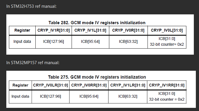

I've found an inconsistency between different reference manuals of STM32 embedding the CRYP peripheral, about the management of IVs in GCM mode:
0693W00000LxERSQA3.pngThe HAL seems to implement the second solution.
Could you confirm ?

Helllo @Gpeti​ ,
looking in the STM32H7 Cryp example for GCM, it seems you are right!
uint32_t InitVector[4] = {0xcafebabe,0xfacedbad,0xdecaf888 , 0x00000002};
 hcryp.Init.pInitVect  = InitVector;
 /* Set the initialization vector and the counter : Initial Counter Block (ICB)*/
  hcryp->Instance->IV0LR = *(uint32_t *)(hcryp->Init.pInitVect);
  hcryp->Instance->IV0RR = *(uint32_t *)(hcryp->Init.pInitVect + 1);
  hcryp->Instance->IV1LR = *(uint32_t *)(hcryp->Init.pInitVect + 2);
  hcryp->Instance->IV1RR = *(uint32_t *)(hcryp->Init.pInitVect + 3);
I will raise the point internally
Thank you raising the point
Best regards
Jocelyn
I've just had a look to the new revision of STM32H753 ref manual and this point has not been adressed. A bit disappointing...
