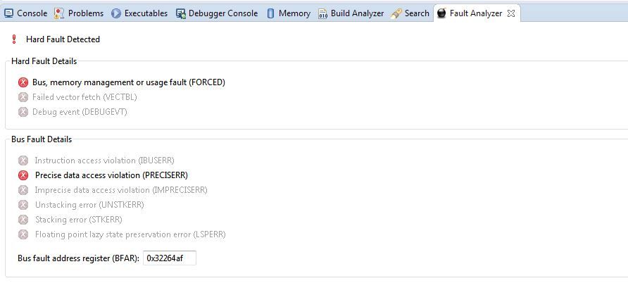

‎2020-07-29 4:03 AM
Hi... @Jocelyn RICARD​ Sir..
Thanks for your kind reply
I have already performed first 2 steps and that's seems working for me
Now for the 3rd step, as per your suggestion, I've set the breakpoints at reset vector at startup_*.s and then press reset
The good news is, SBSFU run first and it's jumping on the reset vector and then after my user application !
But after some execution, my user application causes the hardfault!
The reason is SysTick Or System clock config as i guess
because in SBSFU, systick is used for the synchronization, where as my user application run on FreeRTOS having TIM2 as Systick source
Probably the second reason is, SBSFU run with the MSI as core clock where as in my application I've used HSE as core clock and LSE for the RTC clock
When i set the hardfault analyzer for the then i got to know the hardfault is because of "Precise Data access violation"
The program counter is stuck at void xPortSysTickHandler( void ) of FreeRTOS !
Any recommendations ?
Thanks
‎2020-07-29 6:42 AM
Hello Mahendra,
Ok this is a know issue that will be fixed on next release of SBSFU.
The problem is that systick is not stopped before jumping to application.
The interrupt raises when RTOS has not initialized yet its timer queues.
So, you need to simply deactivate systick interrupt in SBSFU just before the jump.
There are other post on this issue.
Best regards
Jocelyn
‎2020-07-31 4:40 AM
Hi.. @Jocelyn RICARD​ Sir..
The issue has been solved by disabling the Systick
Thanks a lot Sir.. :face_with_steam_from_nose:
