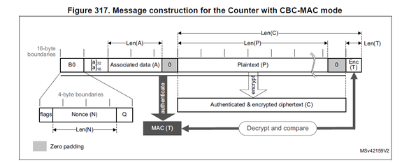

We name it CCM for CBC-MAC.
Please see section 37.4.15 of RM0399.
37.4.15 CRYP AES Counter with CBC-MAC (CCM)
