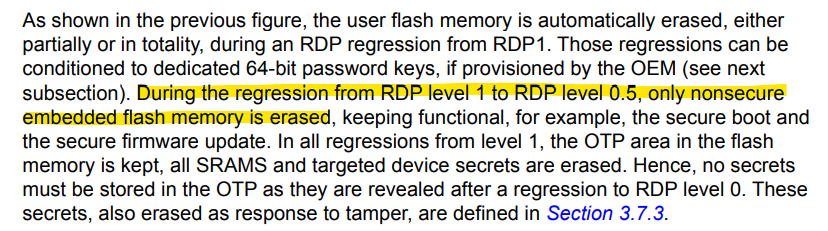

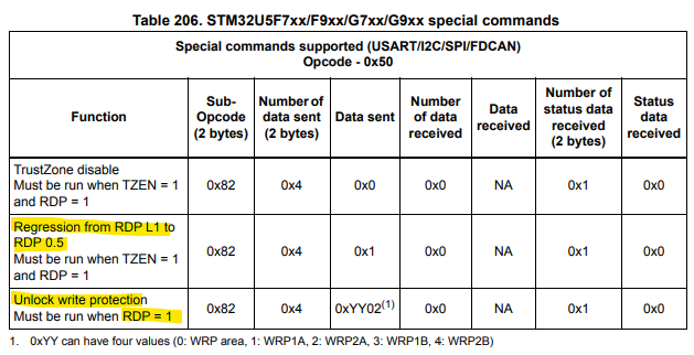

Hi @Jocelyn RICARD ,
I am sorry I am not fimilar with Trustzone, MCUBoot and secure boot. Would they block the access of system memory bootloader?
If I enable RDP level 1 and WRP. Could system memory bootloader disable WRP and then regress RDP to level 0.5 by command?
After regressing RDP to level 0.5, the non secure area would be erased. Then it could perform the firmware upgrade process I mentioned above.
And then enable WRP and restore RDP level  by change option byte in secure boot/application.

Hello @wesleywong ,
I'm sorry for late reply.
First what you suggest is possible. You can program the non secure area when device is in RDP 0.5
But this is not a "secure" way of updating your firmware.
This mechanism is more used in development mode when you provide a device with only secure part programmed and development is made on non secure, possibly using secure services.
There is a firmware update example available. You can find this SBSFU example as an example application of the STM32U585 for instance.
This example allow a setup with secure update using one slot. This example still requires having a secure application and a non secure application. They can be concatenated or not.
The update is using a provided standalone loader applicaiton. So basically you would have a setup like:
SBSFU at beginning of the flash
Secure application
Non secure application
Loader at end of the flash
You jump in the loader through the SBSFU. So, you can trigger the update either through external button read by SBSFU at boot, or through a magic written in RAM by application, reset, SBSFU checks the magic and jumps to loader if requested.
