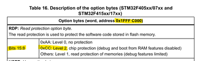

This

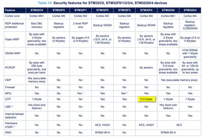

suggests that one cannot execute code from SRAM. Is that really correct?
Also there is ambiguity on whether the OTP area (512 bytes plus the control block) is readable in RDP2. Why say "512 bytes" and not just all-OTP?
The OTP area must remain usable under RDP2 and readable by internal code, but not accessible externally (with a debugger).
Above is from
https://www.st.com/resource/en/application_note/an5156-introduction-to-security-for-stm32-mcus-stmicroelectronics.pdf
No. In RDP2, there's no mechanism to interact with the chip anymore outside of user code. Debug interface is disabled, bootloader can't run.
It says that you cannot boot from SRAM, which is accurate. You can still run code from SRAM if that's what your flash program does. OTP is readable by your user program in RDP2.

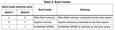

What is "booting from RAM"?
At reset, the CPU goes to the table at VTOR and loads SP and PC from that.
Do you mean that the vector table cannot be RAM-based? I know it cannot be in CCM (because you can't execute code from CCM) but that's a different thing.
Here are the boot options on the STM32F417:
Booting from SRAM is not a typical configuration.
No. Hopefully the above table clarifies that.
If you boot from flash, there are no restrictions on placing or executing anything in flash or SRAM.
