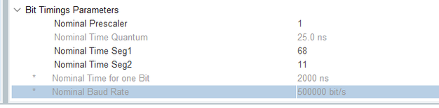

Upload your IOC file so we can see your clock and baud rate settings.

‎2024-05-15 2:12 PM - edited ‎2024-05-15 2:13 PM
IOC file attached, i.e. the one where the problem occurs.
I removed all the code not related to CAN and could not reproduce the problem. Then I went back to the original project and set a watchpoint on writes to txHeader.Identifier. Of course, for this to work, I had to build & run in debug mode (I was running the release mode before). Again the problem didn't appear (not 100% I waited long enough).
Need to investigate further in the next few days, will update as soon as I get some results.
‎2024-05-15 2:35 PM
It's recommended to use HSE instead of HSI for the clock.
Try these recommended settings for the CAN baud rate.
