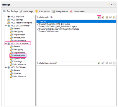

I have included the folder path by right clicking on the project and going to properties. In it Paths & Symbols. Is it right or I am understanding something wrong.
Show a screenshot
Sure Andrew. Below I am attaching the screenshot.
