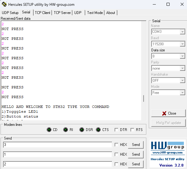

Why UART sometimes print twice the message?

The code is working, but I don't understand why sometimes the serial terminal show me twice.
9 REPLIES 9
Because you're in a tight loop, and send things based on a flag you don't clear immediately.
Sorry I am new in stm32 programming. I think that too but I've add in the Uart callback functions some lines that clear the flags(rx_flag and tx_flag). If I've understand correctly after the transmissions of the data, first the callback function is execute, and then the infinity loop starts again. Is this correct?
while(1)
    if(tx_flag == 1 && rx_flag == 0){
      HAL_UART_Transmit_IT(&huart2,(uint8_t*)tx_message,sizeof(tx_message)); // Called repetitively, returns immediately
while(1)
  tx_flag = 2; // stop repeatedly transmitting, clear in call back on COMPLETION
      HAL_UART_Transmit_IT(&huart2,(uint8_t*)tx_message,sizeof(tx_message)); // Returns immediately
Stuff in the foreground is running continuously. The callbacks occur after something completes, not immediate before it starts.
RX likely needs some work on the logic too.
Also use strlen(), not sizeof() for some string of unpredictable length. Otherwise you'll seen the whole content of the buffer.
Sorry I bore you but I am not understanding. HAL_UART_Transmit_IT() is only use to start the trasmission and return immediately? Then when the transmission end the callback function is execute is this correct? This mean that the UART communication is only start in the while loop and then executed in background?
HAL_UART_Transmit_IT() starts a process by which each character is transmitted and generates an interrupt, when all the characters have been sent the interrupt routine calls your callback function.
HAL_UART_Transmit() would be a blocking function, it does not return until completion.
Karl Yamashita
Lead II
You should try to minimize doing any processing in the interrupt. You don't have much code so it's not going to take up many cycles, but you should poll you data in main loop instead. I've added/modified your code so you can see how I handle HAL status. It complains the text is too large so I've removed sections after main
Things I've noticed
  • You don't check for HAL return status. This will hurt you if you have lot's of data going back and forth.
  • In main while loop you keep calling HAL_UART_Receive_IT() until your flag is cleared. You just need to enable once. Then re-enable after you received a character(s).
  • Though you can call HAL_UART_Transmit_IT() in different places, you should just call it in one place.

Thank you for your code! But it's not clear to me why in my code I am not cleaning the flag. I try to explain. When I enter in the loop for the transmission, first it start the HAL_TRASMIT_IT(), after this instruction then the interrupt start and there the flag are cleared. Why is it not correct?
Karl Yamashita
Lead II
It was already explained by @Community member​ by his code that i'm quoting below.
You need to clear your tx_flag or change it to something other than 1 once you test for it and before you start HAL_UART_Transmit_IT. However if the HAL status returns HAL_BUSY then whatever you're trying to transmit will fail so that is why you need to act upon the HAL status. What I posted will work but I should have added my ring buffer code because the tx_message can be overwritten by new data if you receive some new data before the transmit finishes.
while(1)
