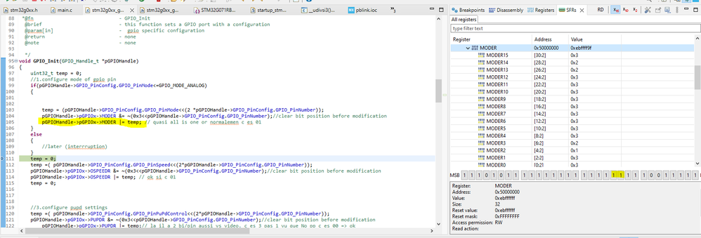

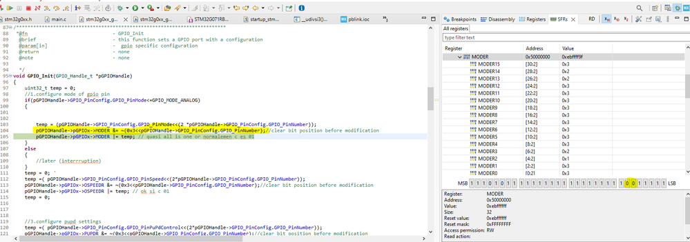

Why toggling LED4 USER doesn't work with this code ( Board nucleo G071RB) ? I know that problem is in my init function. But I don't know how to correct it because GPIOA base adress (which is also MODER register address) is right

image00 : When I try to clear GPIOA MODER register bits, only these one are setted with 0.image01:the bits corresponding to pin number 5 are not setted with the correct values. (It should be 01)

‎2023-01-24 11:59 AM
Thank you for your answer :) But to be honnest with you, I am a total beginner in C as well as in Programming microcontrollers . My purpose is only to adapt the code of a tutorial I have watched in order to make it work on my board. When I will be more confident, I think I'll transform the code in order to make it more optimised (but your commentary on the pins made me laugh:smiling_face_with_smiling_eyes: )
‎2023-01-24 12:05 PM
I wrote all the registers definitions to have a better understanding of the functionement
‎2023-01-24 12:12 PM
Thank you for your answer. Yes it gives me more ideas. I think I should test them when I am more experienced with C. Currently I am following a tutorial. What is ASM generated code ? Is it the code generated by Stm32CubeIde (the one I use).You gave me an idea. I will try to compare this code with mine. Maybe I will get some hint.
‎2023-01-25 4:01 AM
I would like give som update before closing the subject. I have made few mistakes in my code. First of all in
void GPIO_Init
pGPIOHandle->pGPIOx->MODER &= ~(0x3<<pGPIOHandle->GPIO_PinConfig.GPIO_PinNumber);
was not right. I had to write :
pGPIOHandle->pGPIOx->MODER &= ~(0x3<<(pGPIOHandle->GPIO_PinConfig.GPIO_PinNumber*2));
and in my main()
I had forgotten
GpioLed.GPIO_PinConfig.GPIO_PinMode =GPIO_MODE_OUT;
