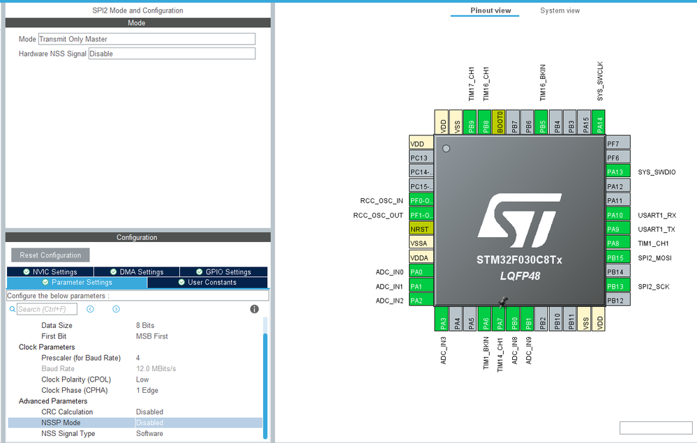

I am trying to connect LCD (SPI interface) to my custom stm32f030c8 board, PB13 -> SCK, PB15 -> MOSI (Transmitt only mode).
I created a test project with cube configurator (attached a screenshot).
I did not change anything in the generated code, just added sending test:

I uses ST-Link to debug. All initializations pass so as the transmit subroutine, but there are no any signals on MOSI and SCK appears (I use oscilloscope with sync by signal front). I tried to change pins mode to general outputs and to toggle output levels manualy, and I got that levels on my oscilloscope, so there are no broken lines.
In SR register only TXE is set, in CR1 register SPE is set, all seems to fine.
So why there are no SPI signals?

You call HAL_SPI_Transmit exactly once after the start. Since you are only transmitting 4 bytes, i.e. 32 bits with 12MHz, it takes approx. 2.7µs after the reset. Are you sure that you will be able to capture this after the reset?
Maybe you put the transmit in the while loop?

This is a false assumption. SPI works similar to a shift register: the clock at SCK occurs exactly during the data to be transmitted, so it is only visible for that long, in your case for 4*8 = 32 bits.
RK.16
I'm sorry, signals are where they should be, my mistake that frequency was too high, and osc's trigger just skipped short pulses. Solution was setting higher prescaler to SPI2 and put transmition into a loop while. Thank you for your responses.
