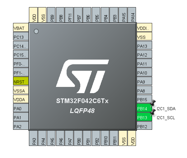

Hello, I have a SMT32F042, i'm trying to use I2C. I used STM32 CubeMX to generale a new blank project with only i2c (see attached). I2C on non standard pins. 0693W00000KcOSeQAN.pngThe problem is that they always stay low, it does not transfer anything.

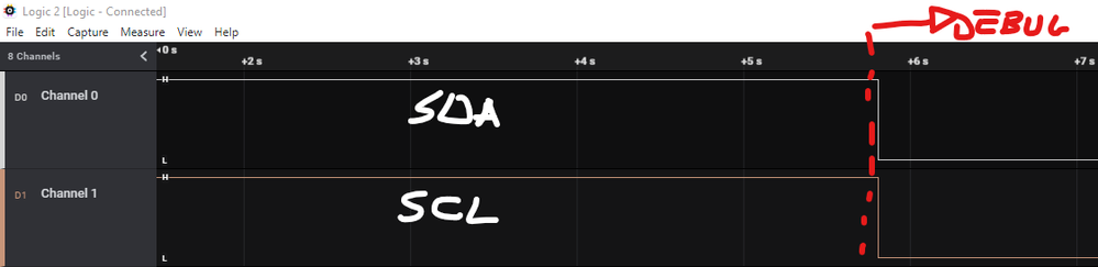

This is what I captured with the logic analyzer, after starting the debug, it goes low.
0693W00000KcOStQAN.pngI attach the code, but it is really standard: https://pastebin.com/ijX9RLEG
I tried also to configure everything as output pin with external pull up (9,5k) and open drain... it works, so my pull up resistor are working.
I really don't know what to check next. THe same come with nucleo works perfectly.
Thank you,

I tried with i2c1 normal pins (PF0 and PF1), and it worked. For my configuration (PB14+PB13) the result is still the same. I ended up that maybe is a but in stm32cube with setting alternate function. Anybody can see something strange?

I2C pins are generally - as you point out yourself - configured as open drain, so they don't normally pull the pin high actively. It _is_ possible to use the internal pull up resistor, but those are in the 50 k range, which would be considered a "weak pull up". It will "probably" work if the transmission lines are short, but in general I2C should be pulled high more aggressively (10k or even lower).

Hello, sorry, I was not clear. In another try and another code, I tried to reconfigure everything as GPIO and I tried WritePin to assure that the pin was not broken and the external pull up was working correctly. And it was working as expected, so I excluded the pullup damage/pin damage/connection issues.
Hello, thank you for your answer. I have a 9,5k pullup resistor. I tried (in a parallet attempt) configuring the pins as GPIO (open drain), and it correctly worked, so I have excluded the pullup damage/pin damage/connection issues.
I am starting to try in blocking mode, using HAL_I2C_Master_Transmit, but HAL_I2C_Master_Transmit_IT does nothing as well. Vdd and Vss are connected correctly
MSalv.1
FOUND! As expected, was a stm32cubemx bug. It did everything for setting up the i2c but did not enable the alternate function registry.
