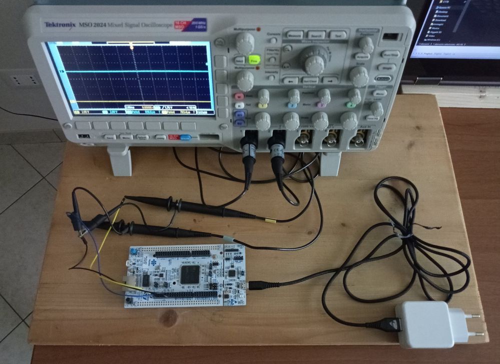

I measure the execution time of a function by putting the toggle of a digital output and the function call into a cycle and measuring the period of the square wave at the digital output with an oscilloscope. The execution time is half a period.

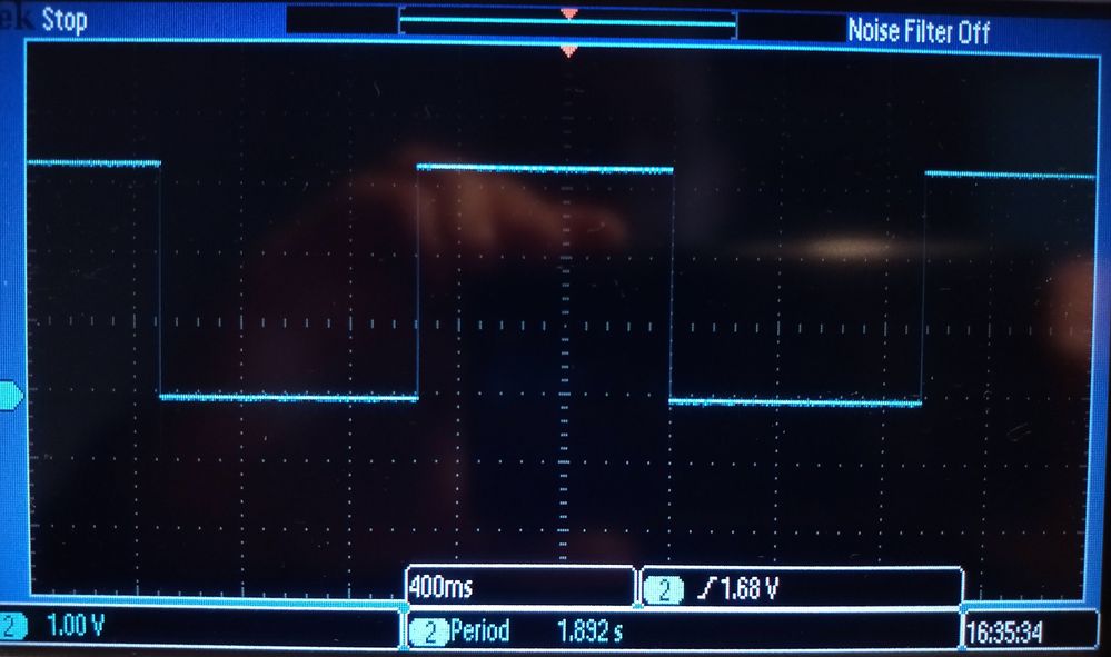

I had similar problems without using the debugger, but measuring times by toggling a digital output and measuring the period with an oscilloscope
0693W00000Ka6K0QAJ.jpgFor example, consider the following code

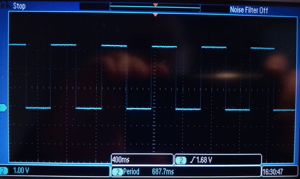

Period measured with oscilloscope of signal at PB10 digital output is 687.7 ms
If you delete line 10
volatile uint32_t system_core_clock_for_watch = SystemCoreClock; // @1
the period becomes 1.892 s (x 2.75)

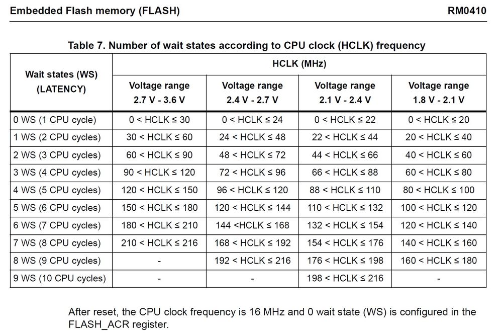

In my original problem, the clock was at 216 MHz and consequently the wait states were actually 7. Now the clock is at 16 MHz and there were no wait states. See tab 7 in the reference manual RM0410 rev 4 below..
