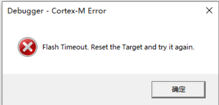

Why does the download fail after changing the code in Keil?

A burning error occurred when I changed the code of smartag1 to max6675 in MDK KEIL: Flash Timeout.Reset the Target and try it again.Above is my modification of the main function code.

mƎALLEm
Hello @Schuyler ,
It could be because you're using a low power mode.
Try to reset the MCU for a moment while connecting to it.
Is that the only information, or is there some other information in the logging window?
Suggest also going into the project settings and debug pane, and perhaps confirming or changing the connectivity settings there.

Schuyler
Senior
@mƎALLEm
Yes, I used the low-power mode, referring to the smartag1 sensor test function, but the code downloaded from the ST website worked fine.
Schuyler
Senior
Hi @Tesla DeLorean
I used ST company's nucleo-L476RG to burn smartag1, but after I changed the code, I could not download successfully, and the above error occurred. I can't rule out whether the code is wrong, can you change the sensor to max6675?
What did you change in the code? you added low power mode or what?
Schuyler
Senior
Hi @mƎALLEm
I used the low power evaluation board STEVAL-SMARTAG1, and the main function for its reference code FP-SNS-SMARTAG1 was changed to the thermocouple sensor of max6675, whose code is given above.
