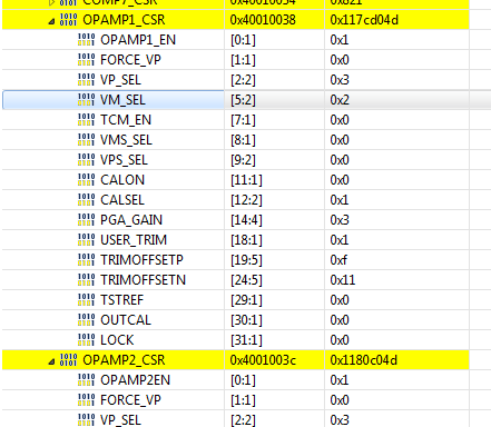

Registers are set as below, read out from the chip by the debugger while running; i.e. the actual values.

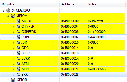

Which 'F303 is that, exactly? How do you measure the OPAMP output? How are the respective GPIO registers set? What is connected to it externally? Can you use a DC input, for testing, of different values than just the described one? What happens if you use a different gain setting?

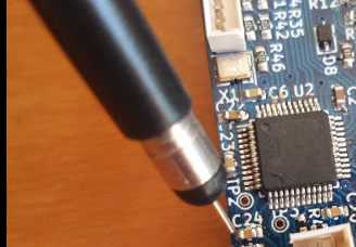

Measure it with oscilloscope, and/or DVM; both yeild the same results. Does the picture I uploaded not show?

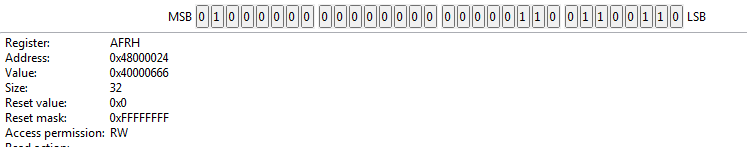

GPIOA registers as in the pics below:

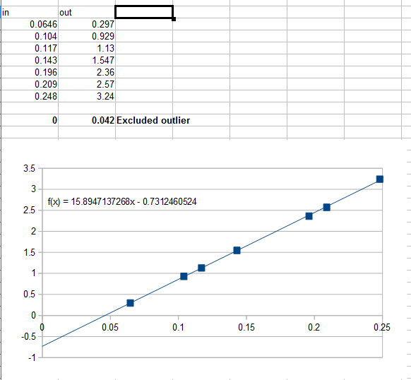

So I went back to school, and sat with my multimeter, plotting input vs output on the broken out opamp4, and got the below:
Dead straight small signal gain line of 16... but nowhere near through the origin. It seems this isn't really a rail to rail opamp, it's a kind of within 50mV of the rail opamp. The datasheet says CMIR 0-VDDA, and the input offset voltage is listed as 4mV maximum calibration range 6mV all conditions... nowhere near the 50mV I'm seeing.
I have another board running ST firmware from the MCWB, and that has a very small offset. I can't get my head around the code they've used to set it up... have they done some magic calibration, or is my chip just knackered?
Is this compensatable reliably, if, say I go and make thousands of these and don;t want to be trimming on a production line?
