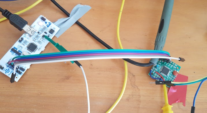

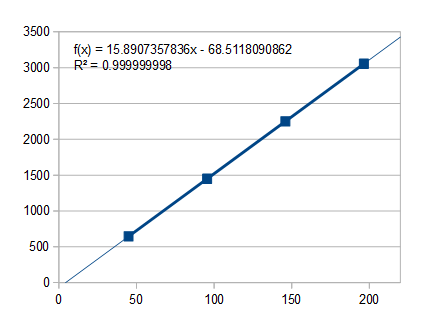

I soldered an F303CB onto a breakout board and programmed it. The results were... mediocre.0693W000003QlKbQAK.png0693W000003QlJTQA0.png
Vin (mv) Vout(mv)
95.5, 1449
196.5, 3054
145.9, 2250
44.9, 645
So the offset seems to be ~4.25mV on this one. Better, but still very much on the high end. Slightly higher than your measurements Jan
Seems there is something systematically dragging the voltage on these chips down.
I'm not concerned about the actual offset so much as the stability - it's 16x gain with a 1mOhm shunt, so that's like 4A offset with 4.25mV offset... I already take a zero current reading on startup (time averaged over 250 samples by exponential decay method) and then subtract that from the later results, which seems to make things work OK...
I've been blundering on regardless with the rest of things, assuming it will all just work out. I guess worst case I end up dropping in some dedicated opamps which I'd rather not have to do since it would take away my PGA, but meh.
waclawek.jan
David,
Thanks for coming back with the results.
I understand that this is a cheap massively digital circuit with slapped-on analog, thus a compromise; but these results appear to be at the edge or slightly beyond of what's promised in the DS.
Also, as you've said, stability still remains as a question.
I still would love to hear some qualified comment from ST. Care to pester them through the web support form or in some other way?
