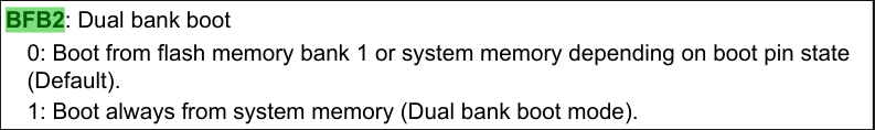

My understanding is that when setting BFB2, Bank 2 is remapped to 0x0800 0000.
Why should we need to set VTOR on reset if thanks to remapping it should interact the same?
Meaning I expect the start of my vector table for app2 to be at the same address as app1 since I have not modified it.

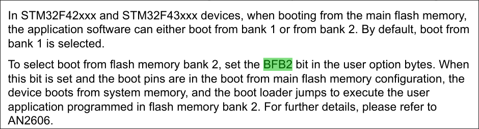

Setting BFB2 will force a boot from system memory according to RM0090.
It says that the system bootloader located there jumps to bank 2.

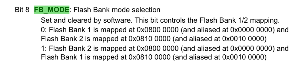

When the device boots after setting BFB2, FB_MODE is also set (I checked via the debugger). Indicating Flash Bank 2 is mapped at 0x0800 0000.
So what is the point of setting VTOR if its default value, 0x0000 0000, is the alias to Flash Bank 2.

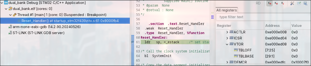

However, something is "not working" so one of the best paths to figuring how why is to debug and investigate. What is VTOR set to that setting it to 0x08000000 fixes the issue?
You may find the problem is something else entirely and this is a red herring.
Thanks TDK,
Sorry for not replying earlier, I somehow missed the notification.

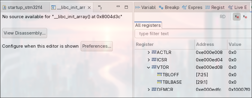

VTOR is set to 0 when I inspect it using the debugger at the reset handler and it stays that way as far as I can see.
The program reaches main and after jumping over MX_ETH_Init() I am brought back to the reset handler for some reason. I recall reading that the ethernet configuration messes with the same register as VTOR I think but I don't know if its related here.

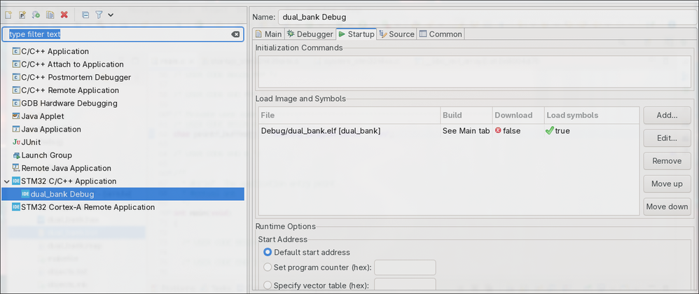

I then disable downloading of the flash application when running with the debugger like so:
I do get this when debugging as well :
Seems strange since the last compiled application is the one for bank 2 (the one I am running currently).
