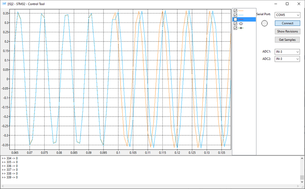

I need to sample 2 signals simultaneously at a rate close to 1MSPS on 16 bits.
On a Nucleo-H743ZI2 board, I thus configured ADC 1 and 2 in Dual regular simultaneous mode, 1.5 Cycle between sampling phases, only one single conversion on each ADC. Sampling is triggered by timer6 at 1MSPS and DMA is used to collect the data (care has been taken about the cache!). ADCs are clocked by PLL2P at 143 MHz which is dived by 4 to reach 35.75 < 36 MHz (from datasheet). With this configuration, I was expecting to be able to sample at a minimum of ~36 MHz / (1.5 cycles + 8.5 cycles) = ~3.6MSPS (from en.STM32H7-Analog-ADC_ADC.pdf). In the worst case it could go down to 3.1 MSPS (I still don't know what the 1.5 Cycle between sampling phases precisely mean in the case of dual ADC mode)
For debugging I sample the same pin, namely PA6 which is connected to ADC1 IN3 and ADC2 IN3. And I discovered that sometimes, ADC2 "jump" one sample.
See attached drawing where ADC1 is in orange and ADC2 in blue, horizontal axis is the time in ms, input signal is a sine wave at 100 KHz.
What could cause this jump?
Sampling rate should already be slow enough, and trying to reduce doesn't seem to improve the results.
There is no other stuff running on the MCU while doing the acquisition (just a UART, which should not be in used during that time)
Thanks for any advice/suggestion....

JLojo

However, I think I found a fix: I just needed to increase the sampling time of ADC1 compared to ADC2.
Probably meaning that DMA transfer is triggered by the end of conversion of ADC1, not taking care of the status of ADC2 (?!?)
My last configuration is as follow, and it works fine!

Just a quick update...
After digging in the Reference Manual, I've been able to make some links between HAL setup by CubeMX and ADC registers...
Strangely enough, when recompiling the project, the acquisitions were stable, but shifted by one sample between both ADCs (but no more jumps).
Thanks to RM, and long time spent trying to fix it, I got a solution, with only 1.5 cycle sampling time on each ADC and absolutely no delays between the two ADCs.
I can't tell what was wrong... maybe around the configuration of DMA (currently ADC2 is set to Regular Conversion data stored in DR register and it works fine...)
