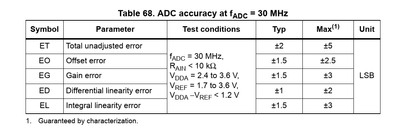

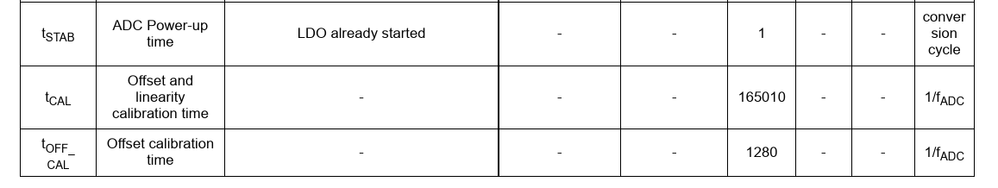

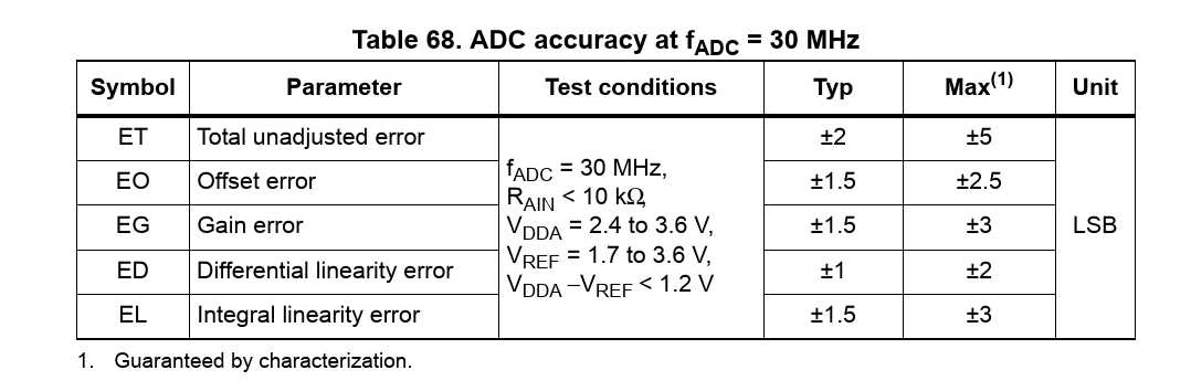

AScha.3
November 7, 2024
The ADCs are SAR-type and so have a bunch of little caps to switch for getting a result.
info see -> https://www.digikey.de/en/articles/analog-basics-part-1-sar-analog-to-digital-converters
or de : https://www.digikey.de/de/articles/analog-basics-part-1-sar-analog-to-digital-converters
So any ADC needs a "calibration cycle" after power up, to adjust the caps/switches , until desired precision is reached.
Thats why you need calibration always at first.
But because you have to do it anyway - some ADC series have built in automatic: after power up or at first use, they do the calib-cycle at first and then run "as usual" , no need to call any calibration by the user.
So just look in ds of your chip -> ADC : if data is like "resolution 10.5 bit " and no remark for "calibrated or after calibration" , then its auto-cal.
...for F401 see ds :
guess , what its doing in this 2..3us after power-up ...!
and:
-> nothing about calibration -> just characterization . start ...ready ...use it.
Otherwise you will find ..remarks (H743 here).:
and also about calibration details :
-> So no need for user calibration, if ADC has built in automatic to do it.

Ozone
Principal
November 7, 2024
> Unfortunately, STM32F4 series ADCs, including the one in your STM32F405RGT6, do not have a built-in calibration function, which is why HAL_ADCEx_Calibration_Start() is unavailable for this series.
I downloaded the datasheet, and this MCU family has indeed no ADC calibration feature.
Of course then there is no point in trying. Remove the HAL call.
> Calibration is important for any ADC to minimize offset and gain errors.
You can either go without, not sure what difference it makes with your application.
Another option would be to use a MCU which allows for ADC calibration, like the F3xx.
And a third option would be an external calibration. Measure a reference source with your F405 board and a reference meter, preferably at several temperatures. You can implement a correction factor / offset into the code from your measurement.
Depending on required precision, this might be necessary for every individual device.
