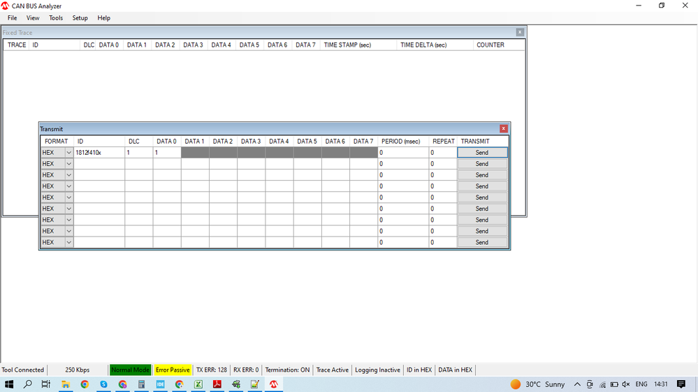

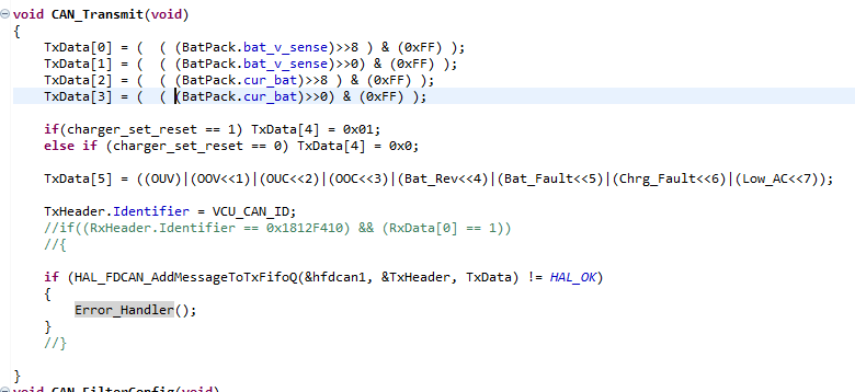

While i am transmitting CAN_Tx data for every 1 second and checking in microchip CAN Analyzer but it showing error passive. Please find the attached software and microchip CAN Analyzer data below. Please support this issue to solve the problem.

how are you initialising the peripheral?
show us the code, are you configuring your stm32 canbus peripheral to run at 250Kb? because thats the baudrate set in your microchip tool

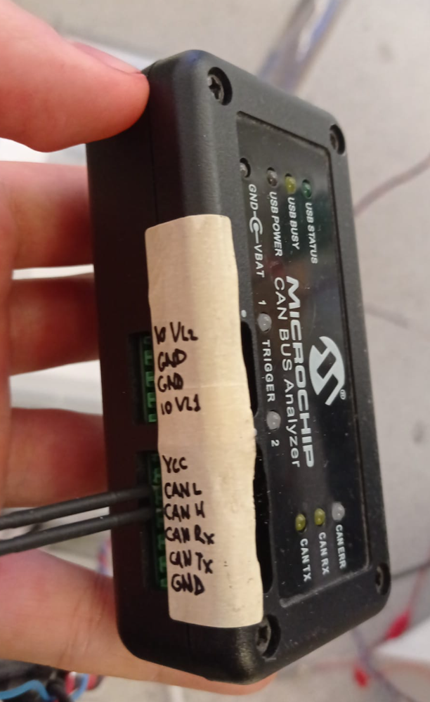

how are you wiring the canbus analyzer?
I do have the same ans i wire it like this. (triple check you did connect canH and canL where they belong)
0693W00000WHZmgQAH.pngAre you correctly terminating the canbus with 120ohm resistors?

its a good habit to check if the canbus mailboxes are full before trying to send anything.
How are your canbus mailboxes doing?
do you have an oscilloscope?
aLSo, are you trying to CAN_Tramsmit inside an interruption¿
